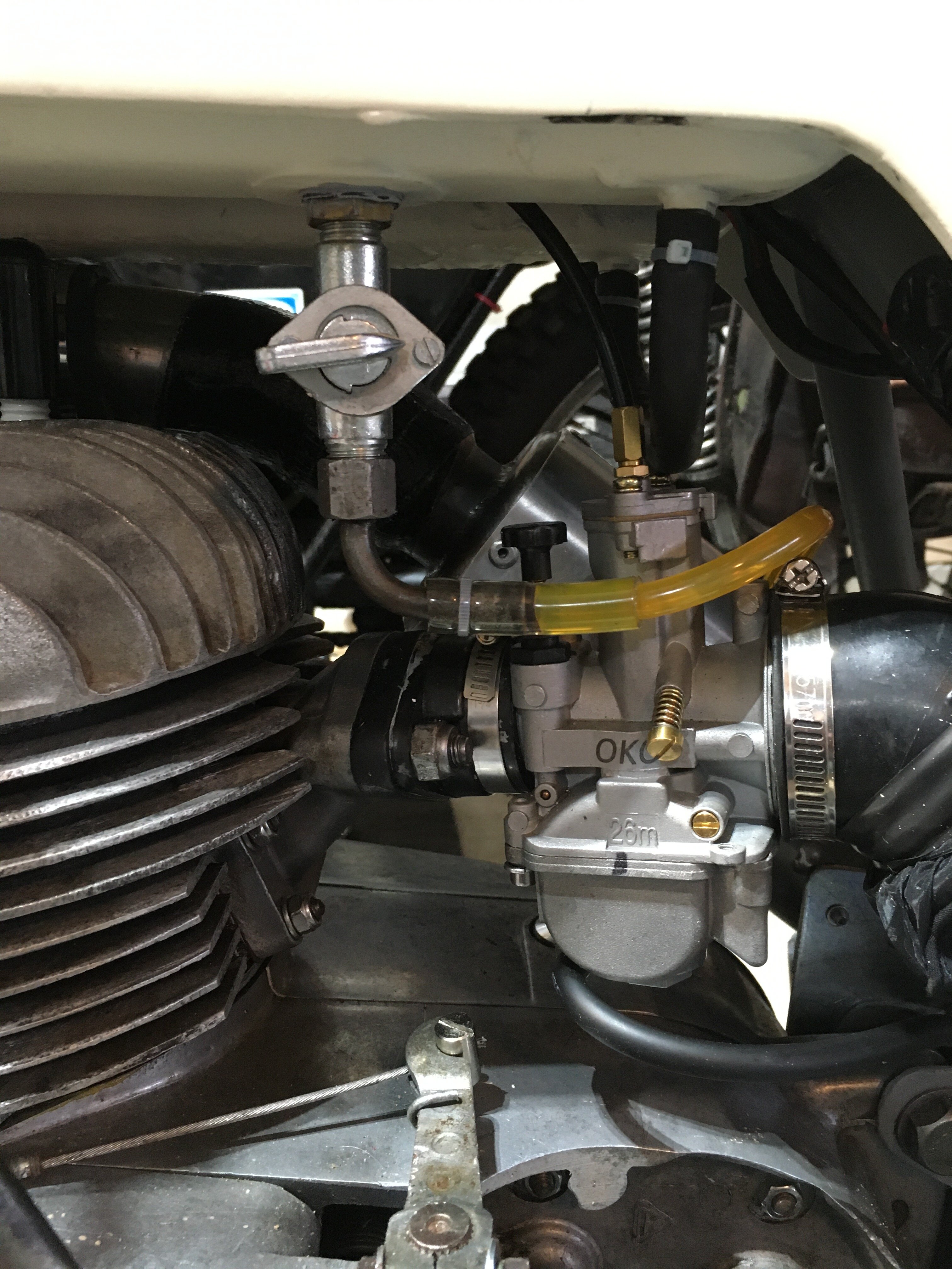

I have a OKO carburetor, Alpina 250, it is working great...
