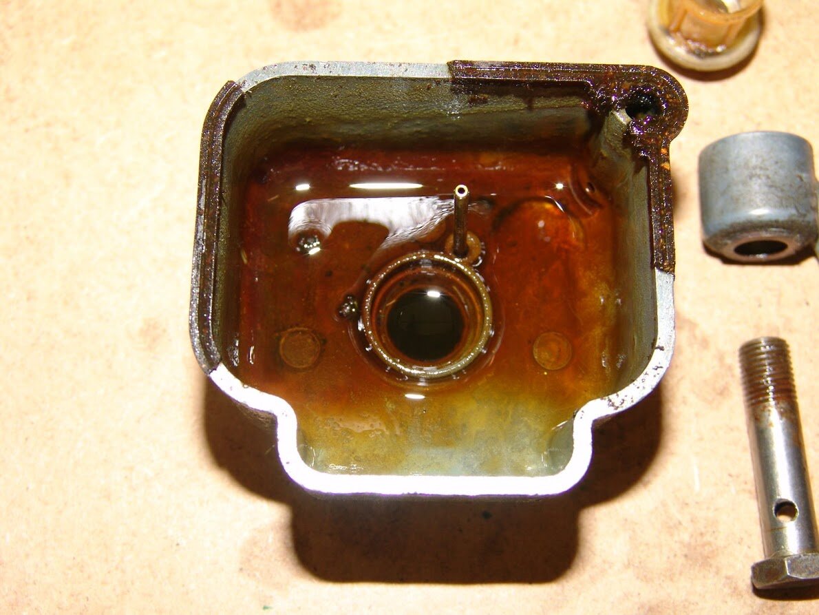

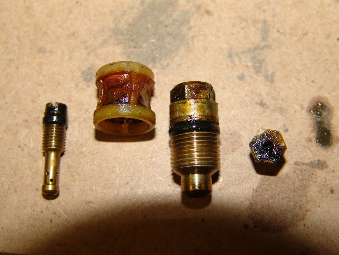

Ethanol is not stable and wil oxidate with oxygen to acetic acid (Essigsäure).
Acetic acid is corrosive against most metals like iron (steel), aluminium and even brass. When you ride the fuel inside the tank is pushed around inside the tank and thus gets contaminated with oxygen which comes through the vent hole.
Looks like that:
It is generally agreed that oxidisation is a minimum of a three to six month process.  Ethanol free petrol has a storage life of perhaps a year.  If you intend to leave any engine for any length of time it is a good idea to drain off the fuel.  My old VFR gelled up many years ago (long before ethanol) when I left it standing for about 10 months.
