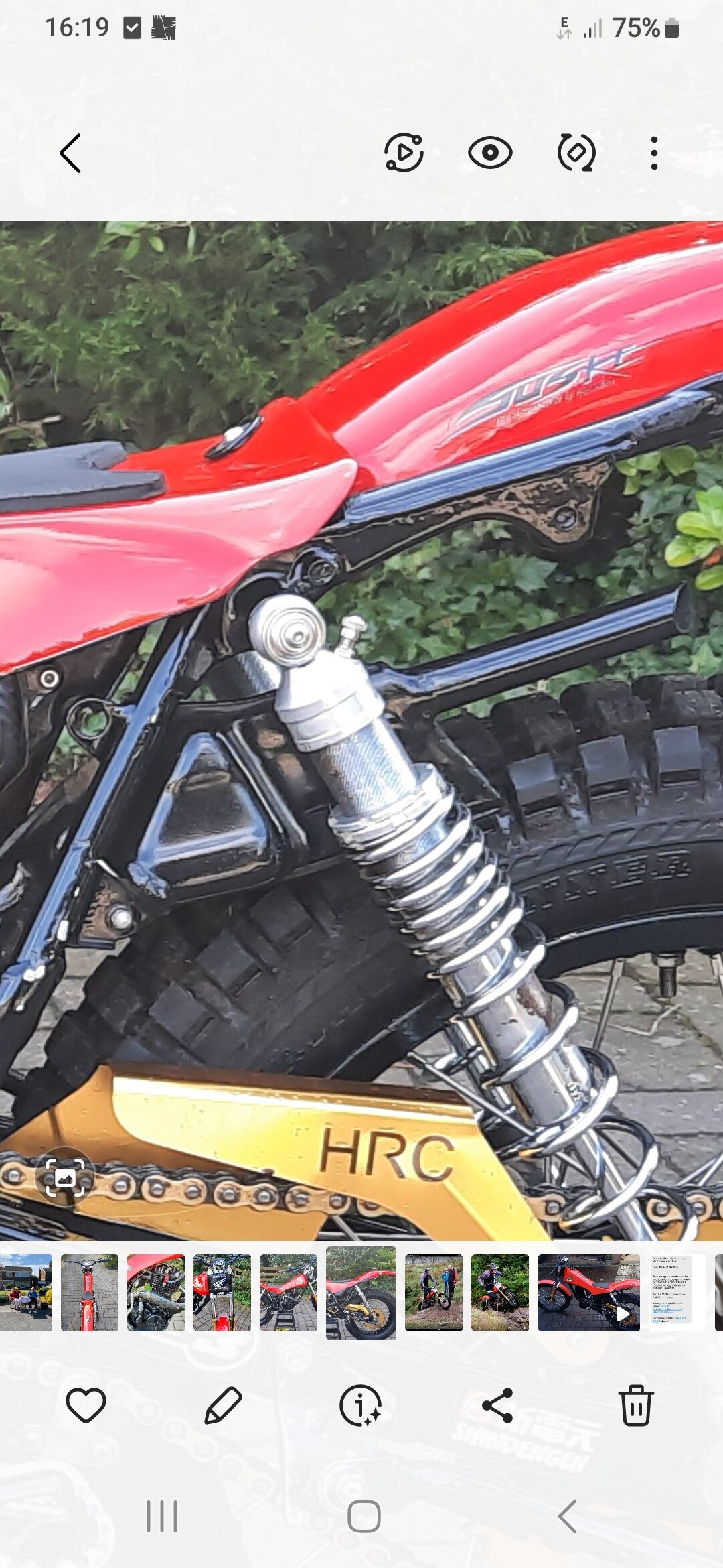

I just posted pictures of my 1986 TLR200 , I replaced rear shocks(with OZO gas from Lewisport USA), rebuilt front shocks, replacement foot pegs, lower & to rear bolt on units from Feked) replaced gas tank (from eBay), got miscellaneous parts off eBay/Amazon/Partzilla, another good source is Feked or In Motion Trials, both in UK and both carry many replacement and upgrade parts for the TLR200. I took off all light off mine as I live in rural area, no cops 🙂 Good luck!
Thank you so much Brother MichaelW! now that's what I'm talkin 'bout! .... love it - and inspiring to see its obviously NOT as terrible as the modern naysayers would have us believe!  appreciate your kind reply (and previous post on your reflex).  OZO shocks. great recommendation, as is everything else coming my way!  Also headin to UK to see family soon so can pick up some stuff direct too.  390mm not 400mm i see falcons and betors are 400mm for the reflex..are the OZOs better at 10mm shorter?

The angle of the shocks affects the leverage ratio, so bare that in mind when specifying spring rate. Moving footrests  back will also require heavier springs. Too soft springs will result in the back end squating and affect your steering, in a bad way. MT43's are a great trail tyre, but a shocking trials one, completely worn out IRC's/ mitchelins are still better than brand new MT's ....
