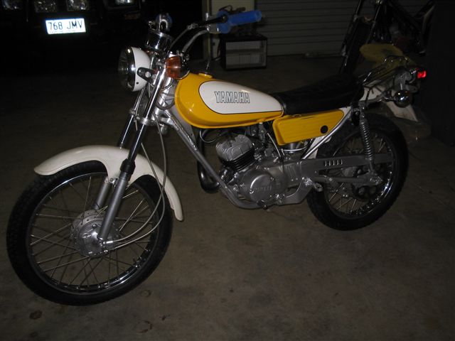

First trial out on my brand new Raga and it falls off the stand (really) and dings the frame. Not badly but enough to really irritate me.
So AFAIK these are the options:
1) Bodge it, fill in ding with araldite and cover with sticker.
2) grind off chrome, fill with brazing and re-spray black (as per 07 Raga?).
3) grind off chrome, fill with brazing rechrome frame ($$$$).
4) drill hole opposite, knock out ding, fill hole. Maybe re-chrome/respray if required.
Any options I might have missed or suggestions?

OH NO!!!!
I'd go for number 4
Panel beaters tool called an Easy-Beat, spot welds a washer to centre of ding, and hooks a slide hammer into washer and pulls out dent. Will damage chrome slightly though !!!!!
