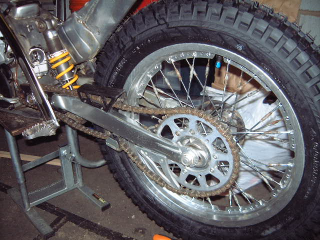

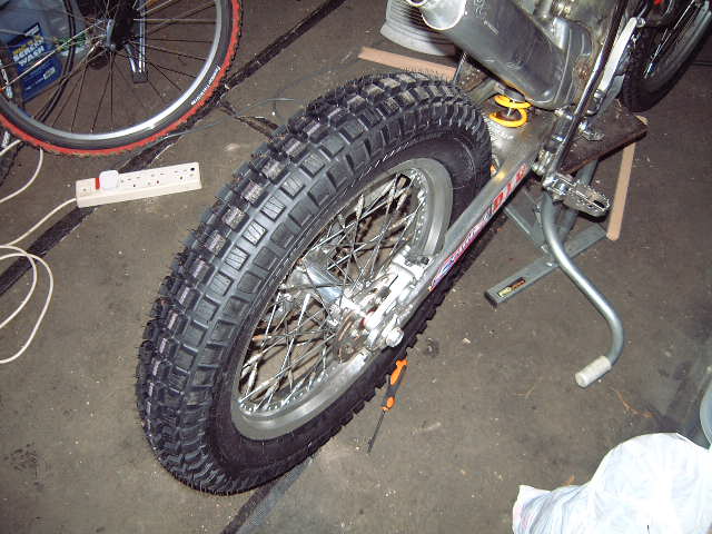

Perfect !
Edited by Subira
And the otherside before I clean and adjust the chain :angry:
Ok now find some of these post 01 wheels for us :D
Dont forget us in the States too! :angry:
Finally the most important thing of all relating to fitting rear wheel form another bike, is whether or not the chain line is correct! Rim offset can also vary, so its sometimes not just a matter of fitting different spacers.
The rim, sprocket and brake disc alignment have all been checked thoroughly (with a vernier) and are spot on, exactly the same as the GG original.
I am sure Ishy checked this to when he's used the Mont wheel in his Sherco and the Scorpa.
Edited by Subira
