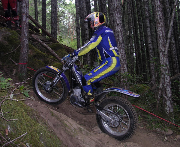

I think it does have a 01 ? 02 front fender on it.
I always run the 2000 front fender they are stiffer and better to mount the mudflap on, but it was on the bike I rode in the ssdt so had to make do with whatever was hung on the garage wall.
The Mont wheel is the older style DID, but it fits right in.
