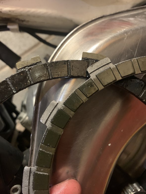

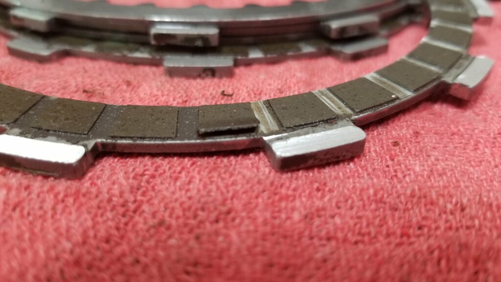

Ok, so I have had a day off work today and just completed this, I cannot believe the difference!!
This is my first trials bike (99 techno) and the clutch stick when cold was so severe the bike would try to climb a wall with the clutch pulled in.
Lauded the bike on its side and pulled the plates and steels. It's the first time I have ever removed a clutch from anything.
The pads were almost indistinguishable from the plates due to the glue. Cue 4 hrs with the needle files and everything all cleaned up and reinstalled.
Once I restarted the bike the clutch now doesn't cold stick at all, also the engagement is 100% smoother.
I can't thank you all enough for the help!!

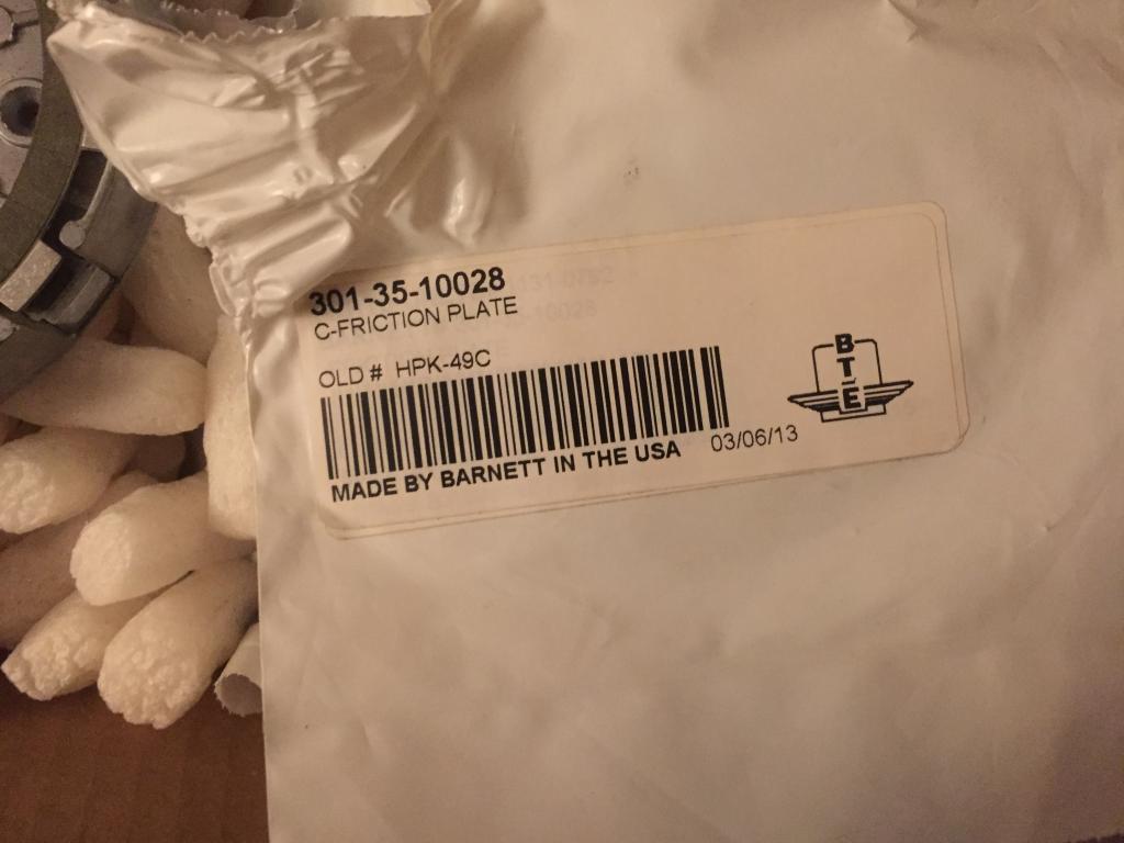

Beta Owners,
Talked with Barnett today.  The friction disks I was sent were from the Honda CRF250.  I have had them in my Evo 250
four stroke for about two months with no problems.  I have been to two events.  Worked perfectly, even with cold oil in the
morning.  The Beta 2 strokes two part numbers in their clutches.  A friend who has a 2011 Evo 300 2t does not see or measure any difference between his disks.  He is going to use a set of Barnett disks in his motor.  The Barnett Part/# is
301-35-10028.  Price is 13.92 per disk for the Kevlar.  Any questions should be forwarded to Barnett.  Parts can be ordered
from local parts or online.  Barnett has a distributor in England.  If you call Barnett in California, ask for Mike Taylor.  I this
helps you solve your problems.  Barnett has a web site. (barnettclutches.com).
This is an edit.  THE CORRECT PART/#  IS:  301-35-0012.  This information was given later from Barnett.
Edited by oslow
These plates DO NOT FIT. Barnett has asked for the part number to be removed from this thread.

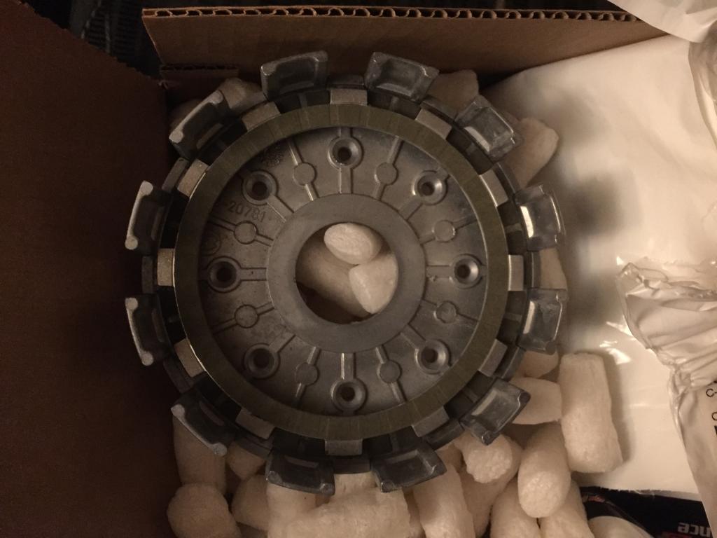

I ordered a set of the Barnett kevlars. Will report when they come in.
They are beautifully finished but they don't fit.
Edited by dan williams
Well that was money well spent. The Barnett plates noted above DO NOT fit. They are considerably smaller than the Beta plates. You may now return to the usual filing and polishing. That is all.
