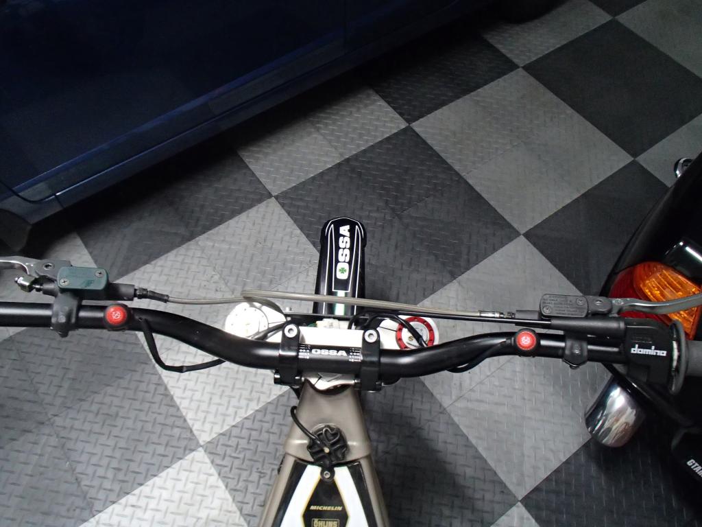

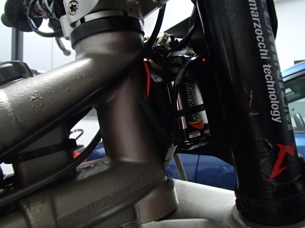

Fitted my es9v easy start kit over the weekend
What a breath of fresh air, a good bikes just
Got better
  • 1 month later...
Thats the one ric, is the factory made kit. it is very easy to make ur own as well, I just have a small switch mounted between the handle bars, easy and convenient. You should be able to find the wiring instruction on that same web site. :beer:
I'm using the DIY 9V system and works great. 3 or Four kicks cold and only one kick hot.
Started on the 3rd kick today and it was only +4c in the garage.I really like the "kill switch" modification.Makes much more sense than the switch at the kickstarter.
