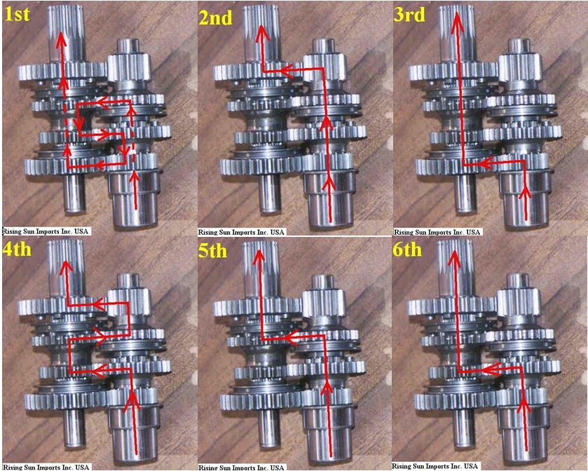

I 've got microsoft Word but that document is blank when I open it...a bit like me? :huh:
Looks like this.....
GJ :wacko:
