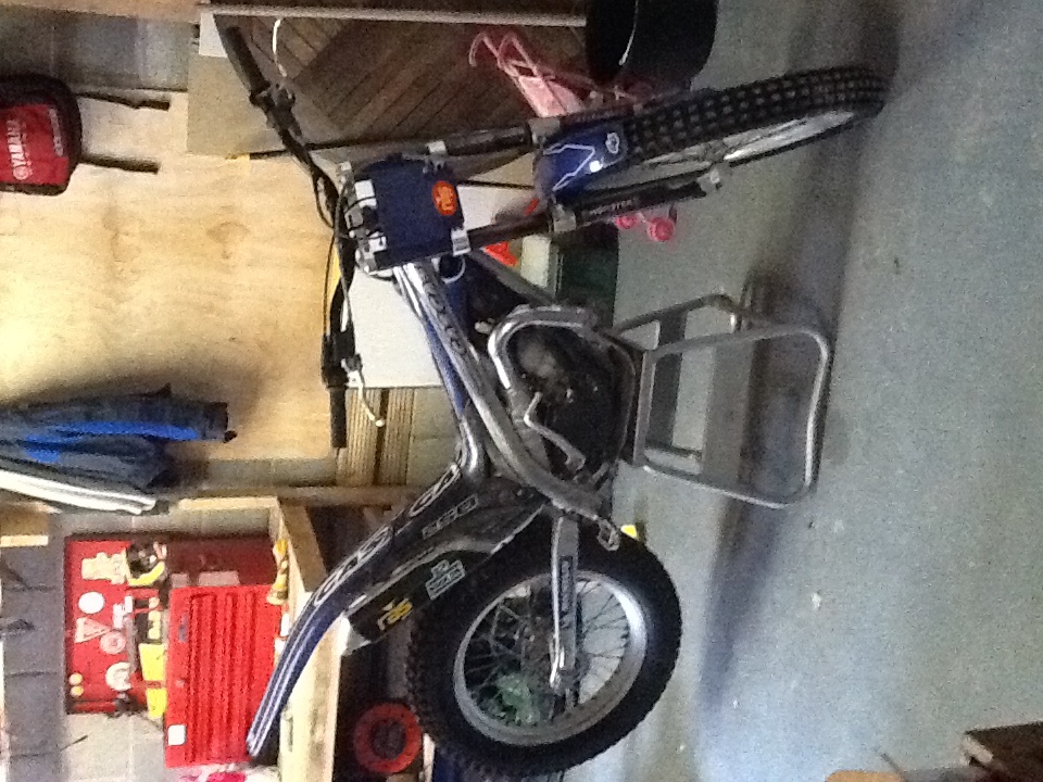

  • This is my Gas Gas. Not the latest one I know, but very little use and all original... even the tyres. Need to use it more.
