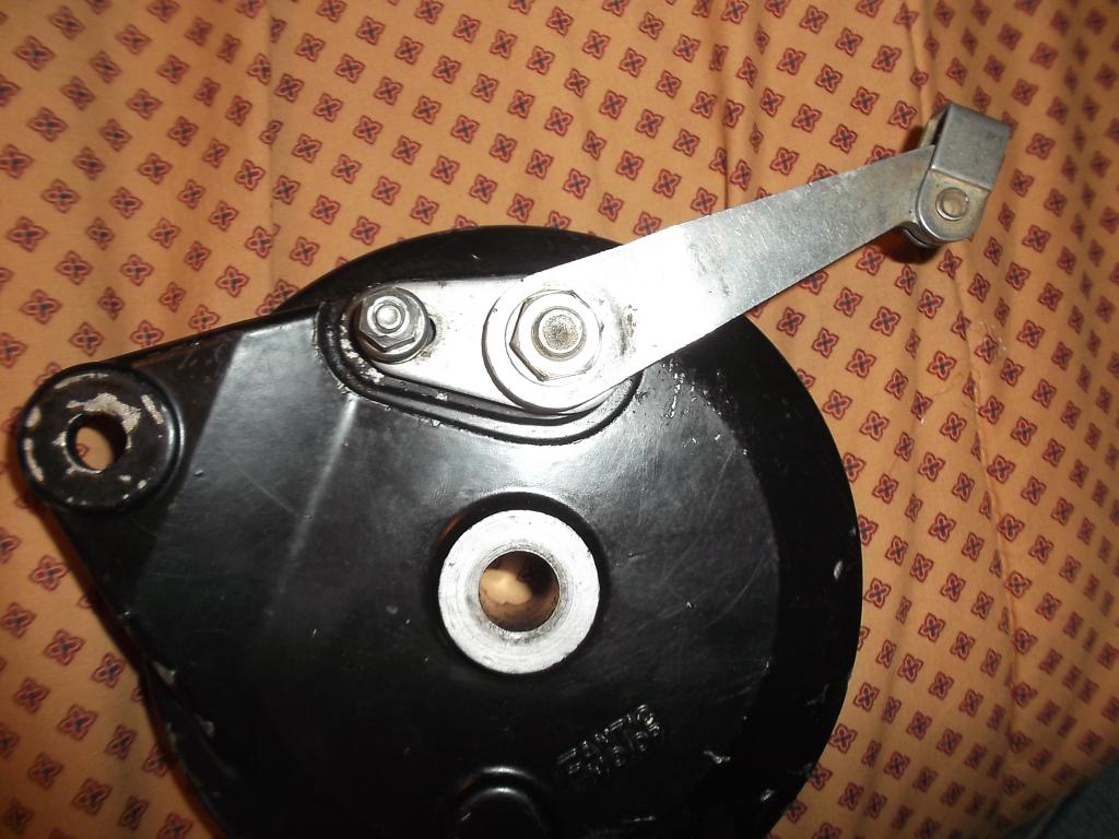

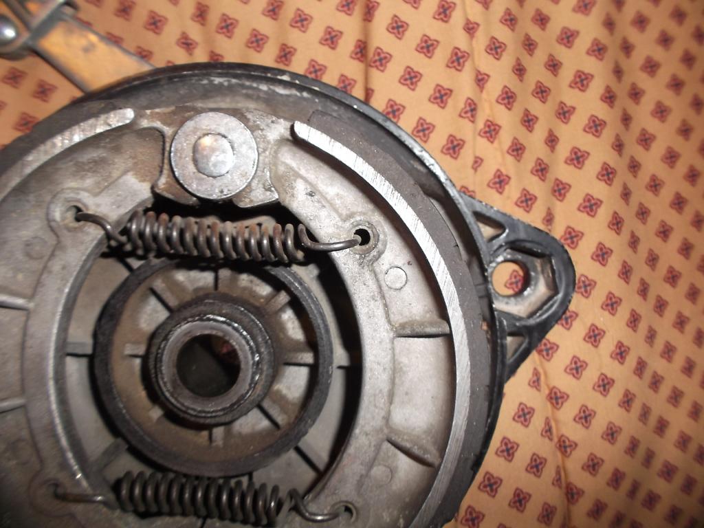

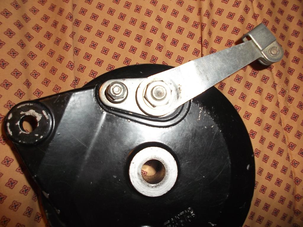

Now that I have it in hand , I can see the ingenious way it works . Even though the shoes are not new , they are in good shape and worn perfectly even the whole length of the lining . :) As you can see in the 2 photo's of the outside , the actuating pivot is on a separate floating mount on the backing plate attached by the small bolt . The secondary plate has about 8mm of forward and aft movement so the shoes center up completely when the brake is applied . I'm gona clean it up and lube it and try it out tomorrow . Will let you know if it's better than the 240 plate with a bored out spindle hole and modified as much as I can ...

I just installed the 300 brake plate . I just putted around the yard for a minute to make sure it works and it does , quite well ... I need to add a small bend to the actuator arm around the fork tube to get the cable end inline with the arm . It's pulling the cable at a small angle ... Details , Details ....
But in the little bit I rode , it feels much more progressive and stronger than the stock plate . I've got a event next weekend , so trial by fire !
Glenn
