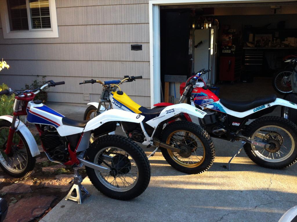

Adopted some new kids and introduced them to the family
Hey!
Family is looking well.
Could I ask what rear mudguard you have on the 301 in the foreground?
Thanks
