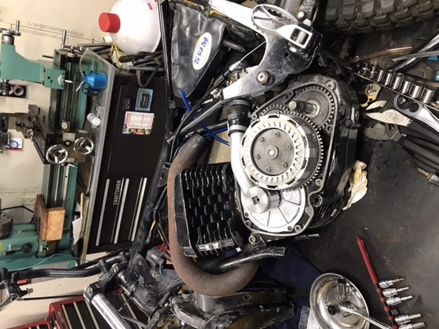

Last week I put together a basket case SWM TL320 from boxes of parts, I’ve had it for a few years and had some time to work on it. All the seals, bearings and rod were replaced. So I was surprised when it started leaking oil. I discovered there was a small crack in the clutch cover where the Kickstarter hub was kicked too far and smashed into the clutch cover. Look there too. Yes you can take the cover off without removing the carb.

Added photo
Magnesium is OK for TIG welding, too. AC/DC, special rods and rather low amps, after cleaning and cleaning again, plus preheating and slow cooling. I case of severe damage, it is the only way out.
Kned metal with the same purpose as aluminium and good for temperatures above 300° celsius to smaller cracks works also fine, did that to some other cracked cases, the casing of my SWM had a dent which I filled with that stuff in 2013 and it is still there.
