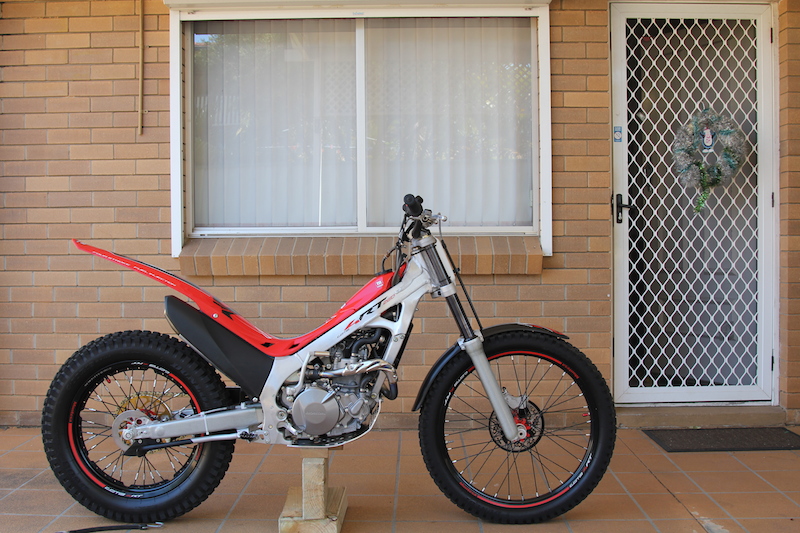

Please provide this info:
The bike info:
Place the bike on a stand (not on the side stand). Take a close up picture of the bars from the side view. We want to get a idea of how you have the bar rotation set up relative to the ground/triple tree.
What gearing do you have, front and rear.
Tell us about you! Height, weight etc.
Do you have long skinny arms, short and stubby arms? Do you have long skinny legs or short stubby legs?
Once I/we have this info we can then advise. :icon_salut:

Billy,
Height 178cm, 5Ft 10"
Weight 88kg or 194 lbs
Inside leg 33 inches, arm length 30 inches to finger tip so probably average length in both?
Penis length, only very average but never had a complaint? 100% satisfaction for me every time I use it!
Gearing was stock at 10-41 but now changed to 10-43.
And some pics...
