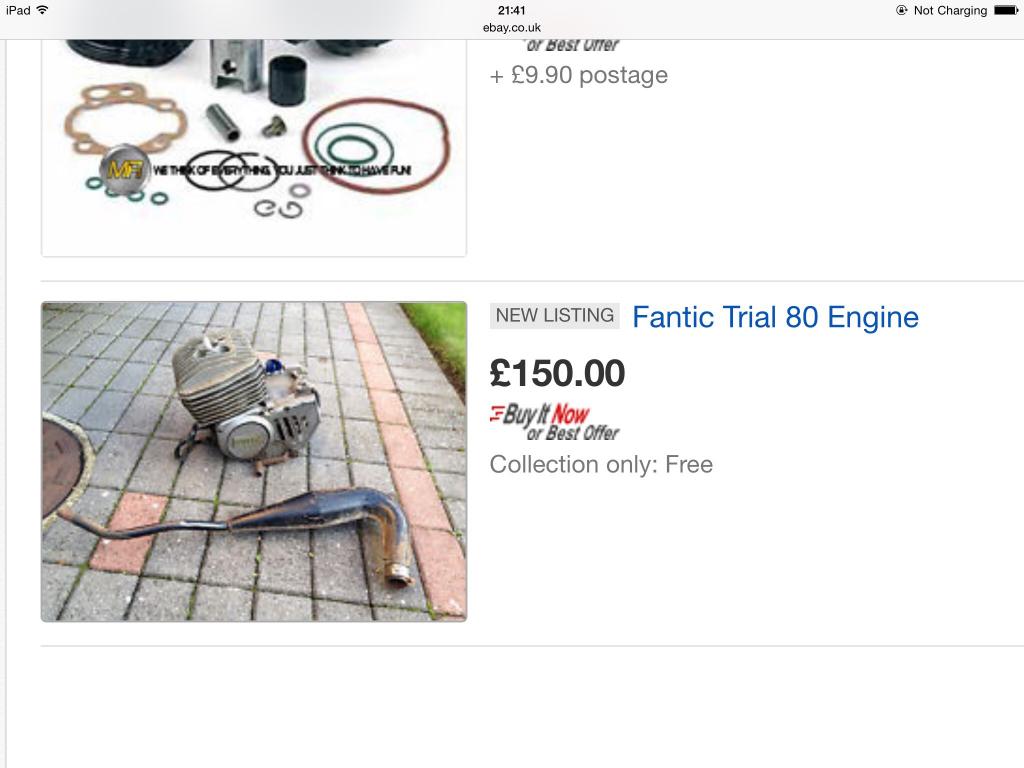

Scrap this if any use,30pound eBay,loads of other engines u can mix and match and big bore 80, minarelli,
