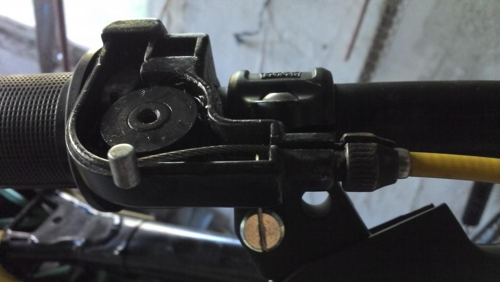

I ordered clutch, throttle and frontbrake cables for my 81 125 and 320 and have had the following problems.
The brake cables were too short and could not be fitted to the bikes any way even though the cables listed were for Marzocchi forks.
The throttle cables fit as long as you only connect one end. The inner is too short or the outer too long on both, whichever way you look at it.
The brake cable issue has been solved. Venhill changed them, no problem but now I'm trying to get the throttle cable problem solved.
The picture shows the throttle end with the carb end in place. Even when all of the adjusters are screwed right in and the cable is pulled to the max (full throttle), it can't be hooked up completely.

  • Mmmh ... the throttle, is it a Domino trials throttle? and have you still  a Dell'Orto carb fitted?   Then the gas cable should fit very well? At least it does to my SWM 320?   To the brake cables

Maybe be the throttle cables are for the original throttles and not the modern type shown in the photo? Not an ideal solution, but you mention the throttle cables is too long. How about unwinding some of the outer cable to make the correct length?
Hi Petert, did just that. Removed the outer to expose 145 mm of inner, works fine.
b40rt, I would have but I wanted to bling the bikes up a bit with yellow cables. Martin only has black ones on offer. C'est la vie !

Hi Patrick, Domino 90 deg trial throttle and standard Dellorto carbs on both bikes. The cable for the 125 is nowhere near what it needs to be. They are in total ok but the sheath needs to be shortened in both cases. The right one was selected when ordered. Same with the clutch and brake cables. The clutch cables were no problem.

Do the end of the cable fit inside the machined notch/hollow of the "connectors" screwed in the top cover of the Dell'Orto the chromed end cap of the outer cable (sleeve) should slide inside quite a bit. To some of these "connectors" the diameter is just a bit to small and you have to drill them up just a tiny bit to make them fit to the cable?
Hi Patrick, as already stated, ' Removed the outer to expose 145 mm of inner, works fine'.

OK cutting away some mm from the outer cable is of course the easiest and best way to solve the issue.

Venhill list a throttle cable for the 82/83 model with code S03-4-004 for Domino 90' throttles, perhaps this is the one we should be ordering!
Guys. the point is, I have two bikes, 81 is embossed on the manufacturers plate, I ordered the cables accordingly and only the clutch cables fit, the others were way, way off.
I have, in the between time, brake cables received which fit and modified the delivered throttle cables to fit.
Venhill offer a lot of cables for a lot of bikes, I don't want to try them all till I find one which fits. I want the one I order to be the one which fits according to the make, model, year and category offered online. That and only that is the point I am trying to make, nothing else.
So john.b, why should I order a cable for an 82/83 model when my bikes both have 81 on the manufacturers plate ?
Because the bikes did nt have Domino side pull throttles in 81/82. We started fitting them in 83 ish as a mod and it looks like Swm did the same. I got caught out as well a couple of months ago, I had to trim the outer cable. Next one I order will be from the later model.
