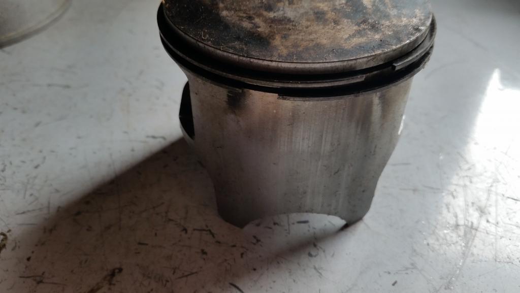

tony27 Posted October 24, 2016 Share Posted October 24, 2016 Fitting the rings is definitely a fingers to compress only job, the ends of the rings will be offset from the centreline by about the same amount but opposite directions which hopefully is visible in this shot of an old piston As a point of reference the inside of the piston is marked Beta, I know this is the exact same piston used in both the Beta 270 & Sherco 290 with Vertex changing the insert in the die for the different manufacturers Quote Link to comment Share on other sites More sharing options...
