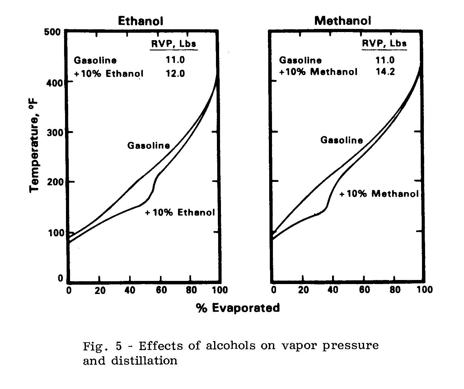

I know mine is. The biggest problem is the ethanol. Without the ethanol the most likely problem is losing some of the lighter hydrocarbons changing the fuel vaporization characteristics but nothing should harm the engine. Just make it a bit of a pain to start. It’s less of an issue when it’s cold and when it’s really cold even the light hydrocarbons pretty much stay put. I usually leave VP ethanol free fuel in my tank all winter and since some will evapoarte just top off before the first ride and go. It’ll smoke a bit more because the ratio has changed from the evaporated fuel but it won’t harm anything.
13 hours ago, dan williams said:
The biggest problem is the ethanol. Without the ethanol the most likely problem is losing some of the lighter hydrocarbons changing the fuel vaporization characteristics....
Below is a graph from SAE paper 790429 that shows exactly that.  Although, somehow, they labeled the units of Reid Vapor Pressure in pounds instead of psi.
But this does not seem to cause much of a problem if the system is sealed.  For example, I leave E10 in my chainsaw (in a cool garage) all winter without ill effects.  I also over-winter gallons of E10 in a sealed plastic container for use in a 4T backup generator.   You would think that if all the light ends had gotten out, it would affect cold starting, but I really don't notice anything.
BTW, I read your clutch fix a long time ago (a friend showed it to me when she was having trouble with a Beta clutch).  The format gave me the idea to make .pdf files for use on message boards.  So, thanks for that!  Here is a link to my thoughts on ethanol (and lead) in gasoline.
