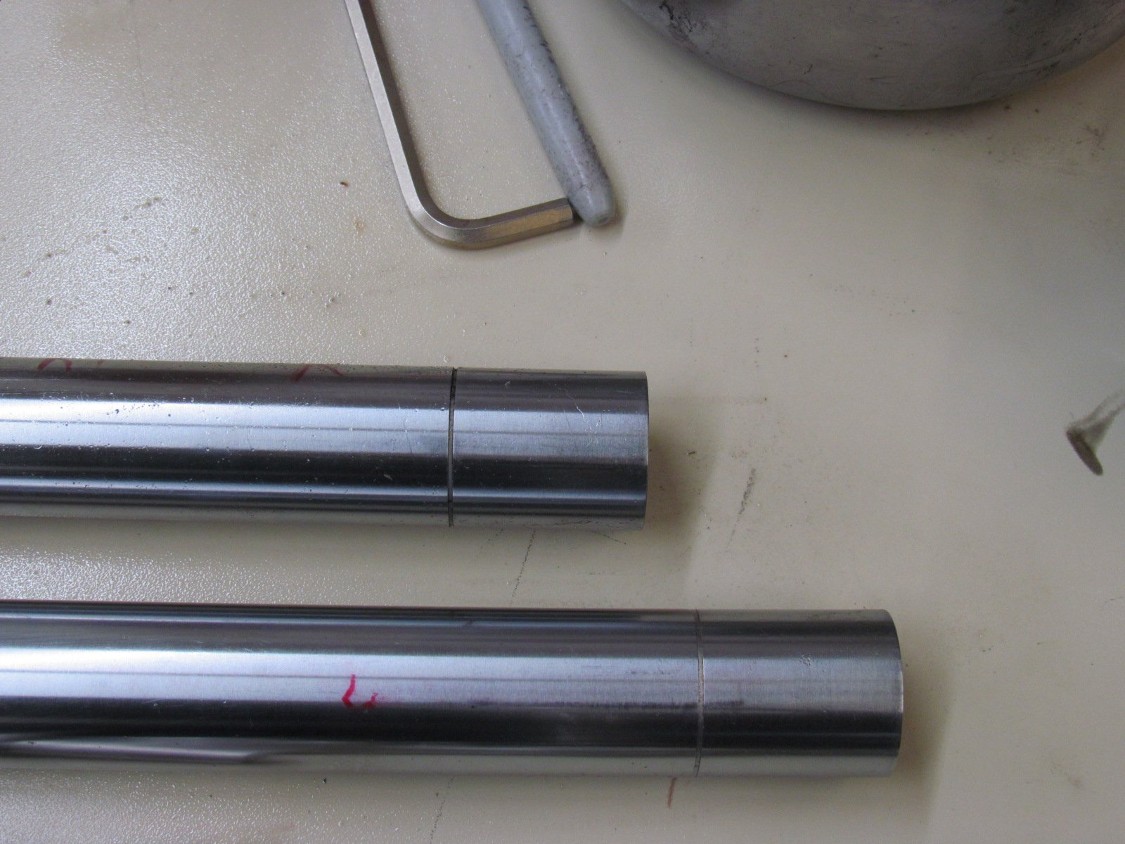

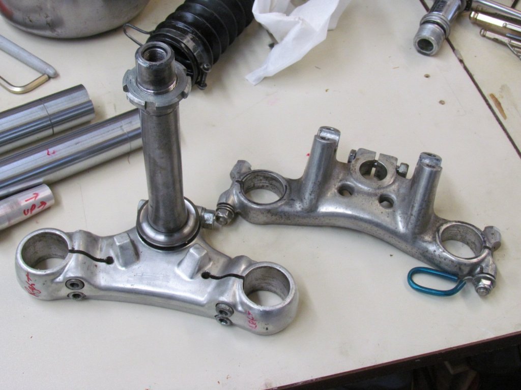

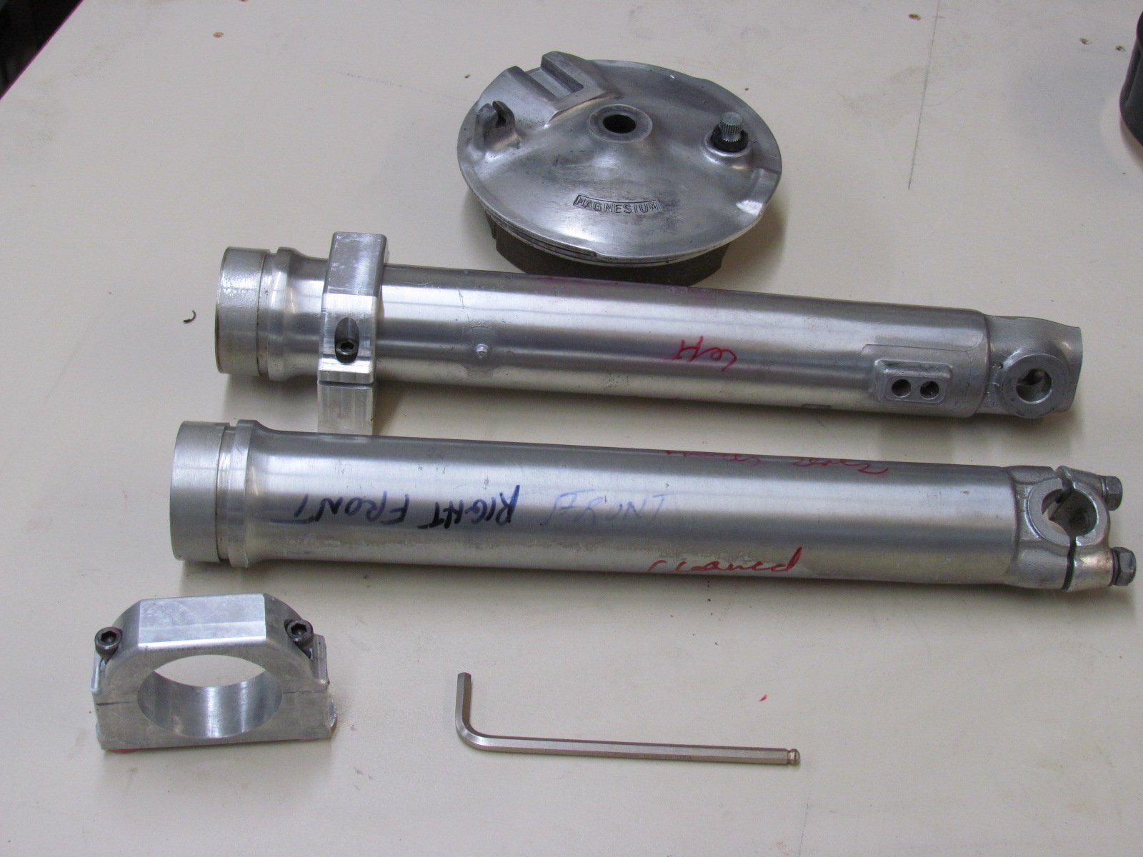

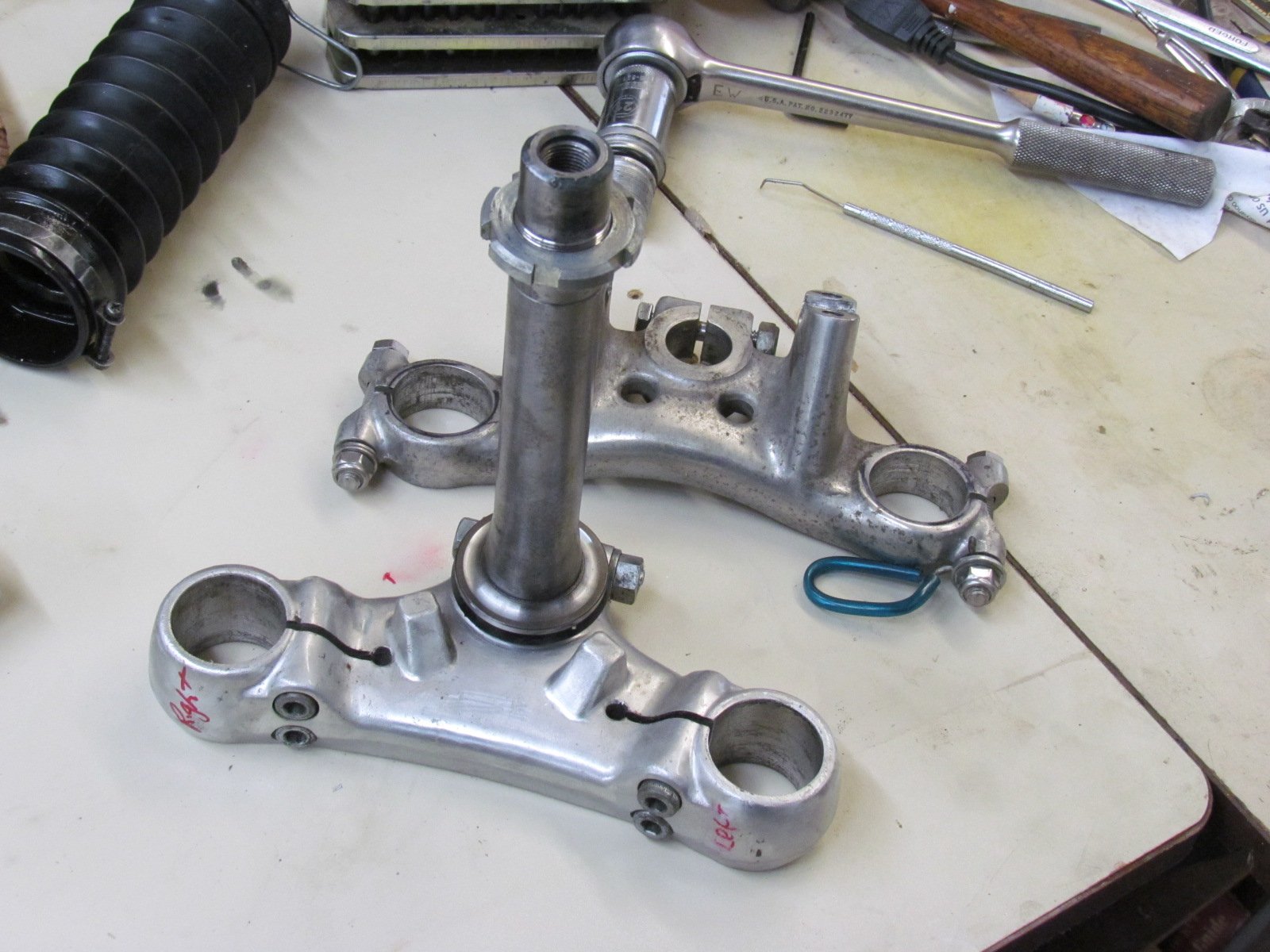

You have raised a good point about the clearances behind and above the new fender that I had not thought of. .  Fortunately, the new brackets are somewhat adjustable up and down the lower fork legs so the fender can be adjusted up or down about an inch or so,  and also the fork tubes themselves are about an inch and a half longer than they need to be. These are TYB forks and the last 2 inches at the top of the tubes looks to be a separate piece, although they have resisted my best efforts to unscrew them. I can't tell if the triple clamps are Yamaha, or they have also been swapped out for the TYB.  I will include some pictures here and maybe you can tell if they are Yamaha triple clamps?  I had to replace the lower balls and races inside the center post, and I ordered Yamaha parts for that and they fit the frame and the center post perfectly, so i think it's just the fork legs and front wheel assembly that was swapped out. ?

Your triple clamps are TY Yamaha. Your fork sliders are MX or YZ Yamaha and your brake backing plate is MX or YZ Yamaha. The lines on the fork tubes are there as a reference for where to clamp them on the bike that they originally came from. If they are longer tubes than TY250A then they are not TY250B, because all the TY250 twinshocks have the same length fork tubes. I would expect that the fork tubes are also off a MX or YZ Yamaha.
To maintain the standard TY steering geometry you should set the tubes so that the axle is in the same position as it would be with TY forks. If the travel of your forks is longer than TY forks you may need to fit travel limiting spacers to the damper rods, to avoid the mudguard or tyre hitting the lower triple clamp.
