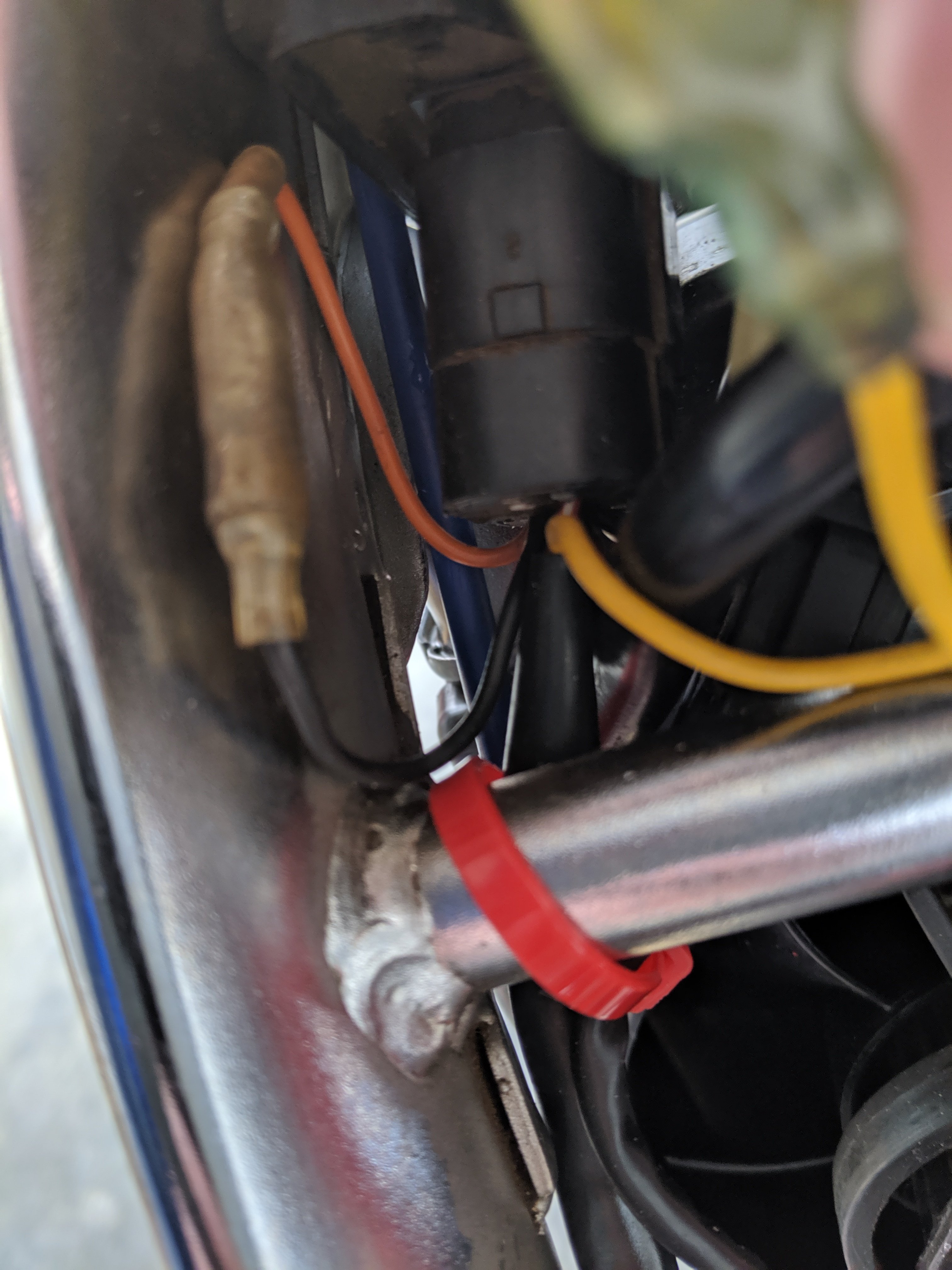

Is this the orange wire you are talking about ?
If I disconnected this will it simply allow the bike to rev higher ?
Hi Steve it will become easier as you get used to it just find somewhere fairly open to play ride around, at least you now know what happens when you open her up.
Yes those are the wires on your photo so you are already on the rainy setting.
There is only a very subtle difference between the 2 ignition settings, One is intended for slippy conditions with a very slightly softer power band with slightly restricted top revs. The second one is just normal.  The switch if fitted is only an open/closed switch, the 2 wires I mentioned are connected together for the softer one and just disconnected from each other for normal one. ?
