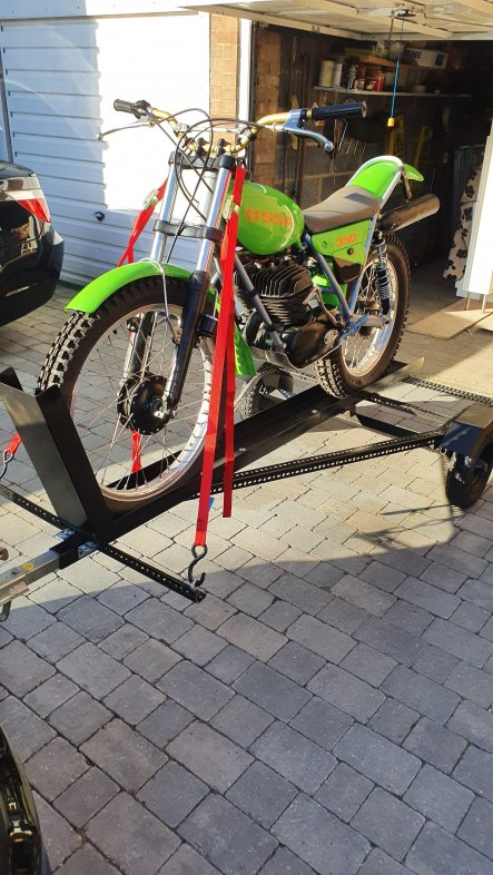

Hi guys,
After soom advise on what fuel mixture to run in my TR77 350, been a long time in coming but final got out on my bike this weekend after 30 years in boxes.
i'm running it at 40:1 mixture and leaving clouds of blue smoke in my wake.
Thanks Rick
