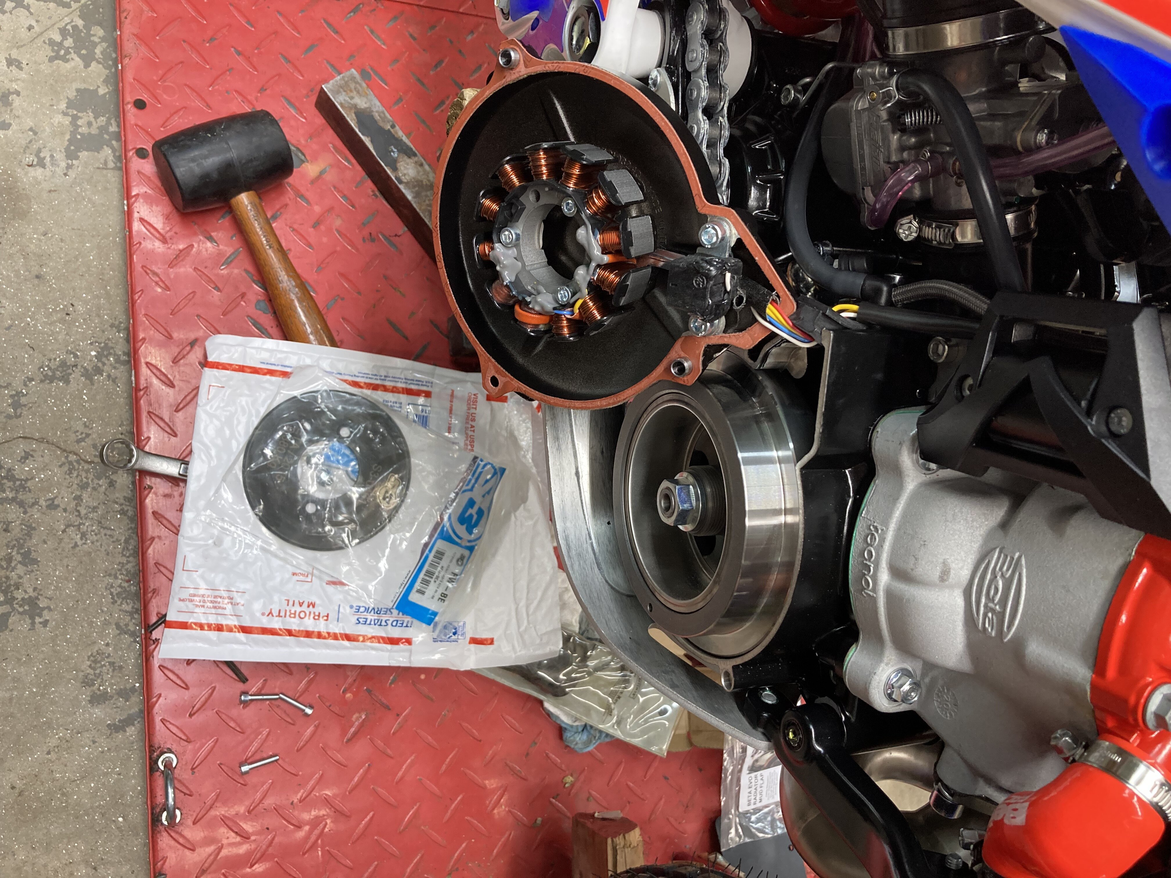

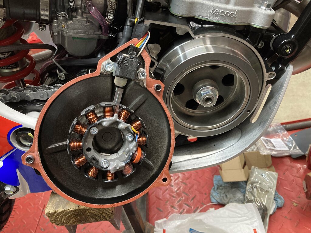

wheelieman14 Posted September 14, 2021 Report Share Posted September 14, 2021 (edited) Up close view of 2021 Beta Evo Factory 200 Flywheel, which now appears to be very similar to the Flywheel used in the bigger brother Evo 250/300 models, but turned down for less Mass. S3 Flywheel weight Part# FW-BE (weighs 13.7 oz.) was intended for older Evo 250-290 models (with plastic flywheel cover), but should fit at least through 2019 Beta Evo 200 Standard models. Here is reference of Flywheels for later model Beta Evo models: 2021 Evo 200 Factory stock flywheel (as shown in picture) weighs 5 lbs, 4 oz. 2016 Evo 300 stock flywheel weighs 6 lbs, 4 oz 2016 Evo 300 Super Smooth (Beta Part# AB-80015-H) weighs 6 lbs, 14 oz Edited September 14, 2021 by wheelieman14 Added actual weight of S3 FW-BE add-on Flywheel weight Quote Link to comment Share on other sites More sharing options...
