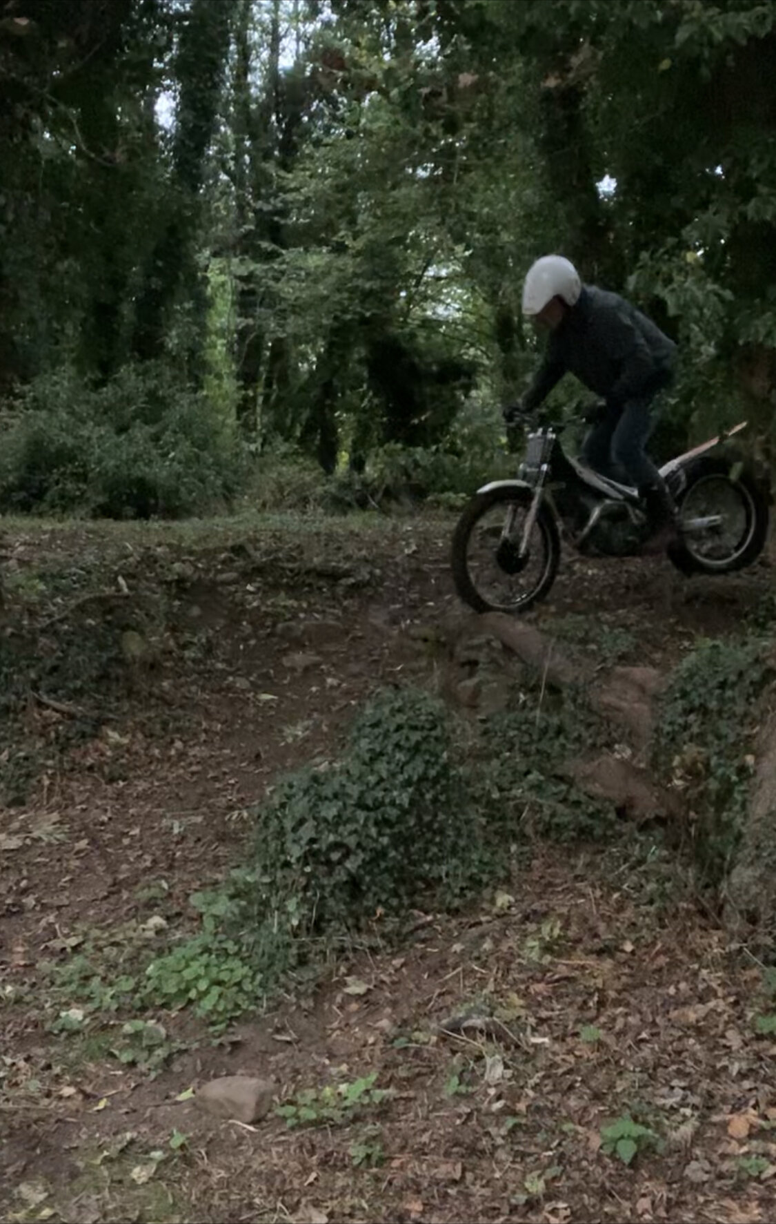

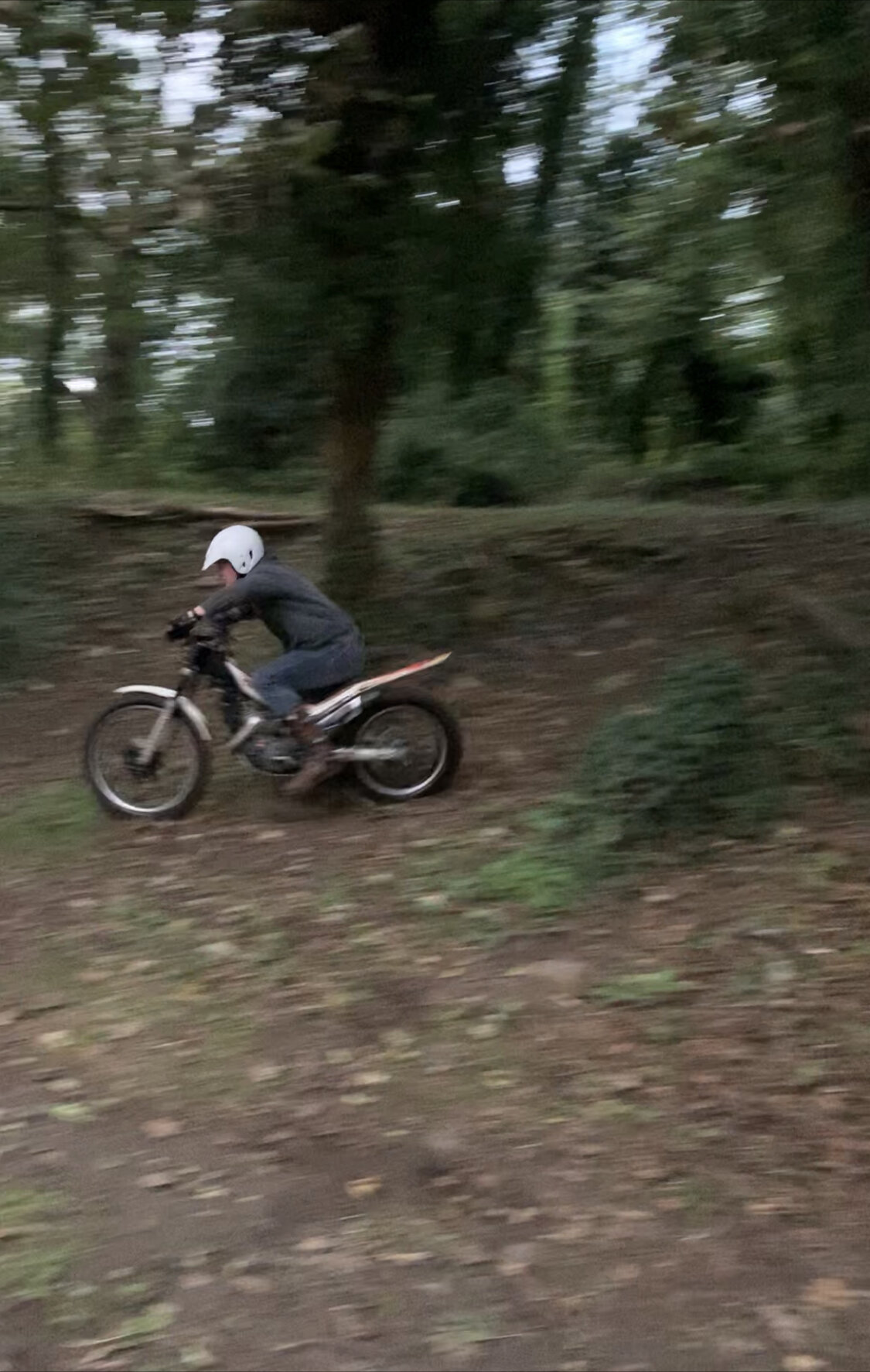

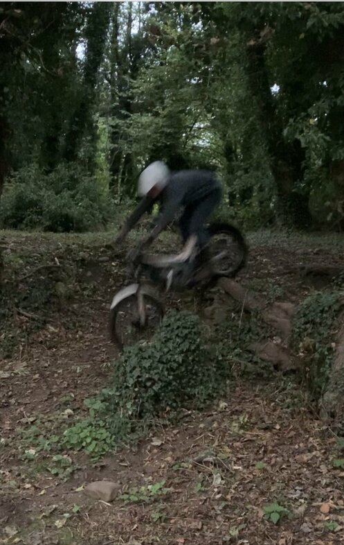

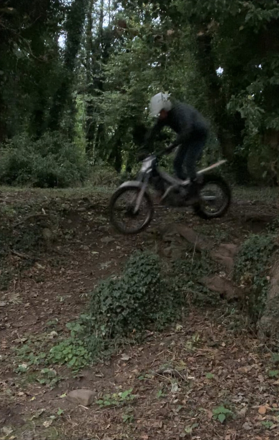

I’m having an issue that I’ve experienced twice now when trying a drop off. When I practice a drop off on a token ledge (30cm onto flat ground), it all goes fine. But when I try something bigger or a drop off that’s onto a hill, I’ve had this issue that the bike starts to rapidly accelerate around when my front wheel touches the ground, it flys away and I fall off! I’m convinced this is my fault and not the bike (as is usually the case)!
I managed to get some rough footage of when this last happened to me, and my assumption is this; when I approach a roll off, I position my body weight to the back of the bike at the top of the hill/step and roll down fine. When I try drop off initially I’m stood up to compress and initiate a small wheelie, when the front wheel goes over and the bike drops changing it’s angle my body position changes causing me to inadvertently twist the throttle….I think!

Relevant. You don’t need to land on the gas like in MX. But pay attention to what Ryno is saying about body position and your knees. From your pics it looks like as you land you are falling back and down into a squat and pulling on the bars a bit, just as Ryan warns can happen in an mx jump landing.

 Also your levers are too low to ever have full control.
Your last picture in that second post sure looks like what linaway is saying.  The levers look low and if that is the case it would defiantly cause throttle issues (whiskey throttle or other throttle control issues) to happen.  It seems counter to bring them up and can feel strange when you first do it but its well worth it and will/can make trials riding so much better.
