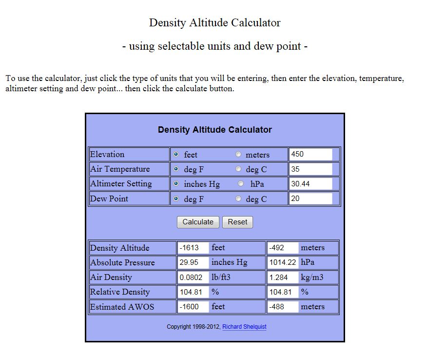

I had noticed a large swing in altimeter setting upon preflight, did not think too much about it, yet a bit unusual. I have now spent many hours trying to find out what is wrong with the motor, disecting magnetos, carb and such, to no avail.
However, I did recall the bloody altimeter setting, so I just ran the numbers on this and feck me!
I have never seen such numbers! No wonder it declined to run well under load yet smoothed out whth heat applied!
Not sure anyone is going to believe me on this! Does this happen there? I am now a submarine!

Was there a serious cold front moving thru the area at the same time ?
Front had passed, it was clear and dry! I checked today, still cold here as I do not think it got over about 37f, and baro was still high at 30.25, density altitude was near -1250 feet, but not -1650.
I made some calls today, and I have not found anyone yet that has experienced this, yet at the same time, they all say that planes are not designed to run below sea level!

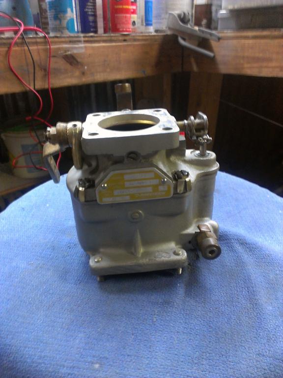

Fecking carb is off for flow testing at factory! What a PITA!
