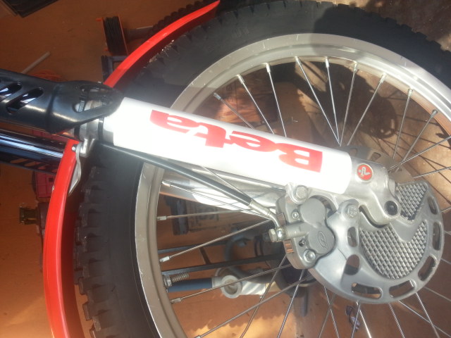

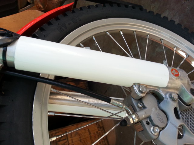

Im not sure if im the first to think of this but heres my super cheap, super easy fork lower guards.
50mm pvc pipe, cut to length, cut out a strip down the length (about 20mm wide), snap on.
Done.
I do exactly the same on my Ossa's, central vac tubing is what I use, $8 for an 8ft length, makes 4 sets. A very cheap and effective was to protect the lower tubes.

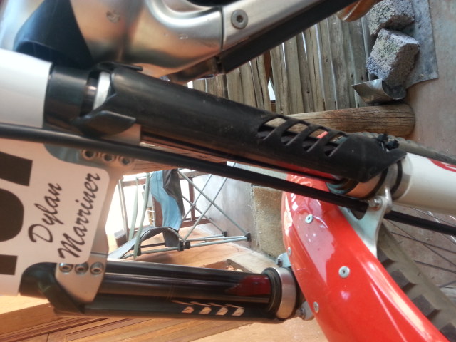

I was asked about the upper guards on my bike. I got the bike with them but most guys in sa have them fitted. A guy named graham on trials.co.za would be able to give you info on them. His email address is on the sight. Cost about R400 ($40).
