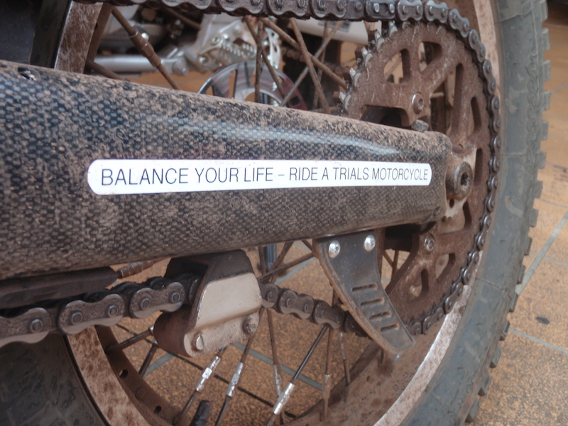

This is the wife's bike after a day trip to local ride area... would you leave this for another day ride and just hit it with more lube?

Hi Mags, Looks like the chain in the photo is due for adjustment as well as lube.

Good pick up there Taff! Chain adjusted AND un-dusted! Hehehehe
