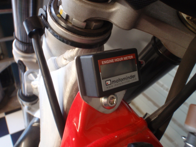

I have hour meters mounted on both bikes (pic below of Montesa) Beta is mounted near top of rear shock.
Ours are 4 stroke so a little different to 2 stroke.
I change the motor oil every 10 hrs in the Montesa and the motor filter every 20 hrs. I'm using semi-synth so is very cheap to do the motor compared to full synth.
The gearbox oil in full synth I drop out every 20 hrs. The clutch characteristic doesnt seem to change from hour 1 to hour 20 so I'm happy with that interval.
The Beta not having a separate gearbox oil and filter I changed every 15 hrs. I use Panolin 10w-50 as recommended in the Manual.
Because acid build up is a byproduct of combustion and can etch metals I never let an oil go past 6 months if the hours are not done on the engine. I will do a filter as well with the 6 month service.
On new engines be it motorcycle or car I bed rings in and drop oil and filter or at around 150 kilometres. Next change is the first scheduled change by manufacturer... if over 1 ,000 kilometres I'll split that again.

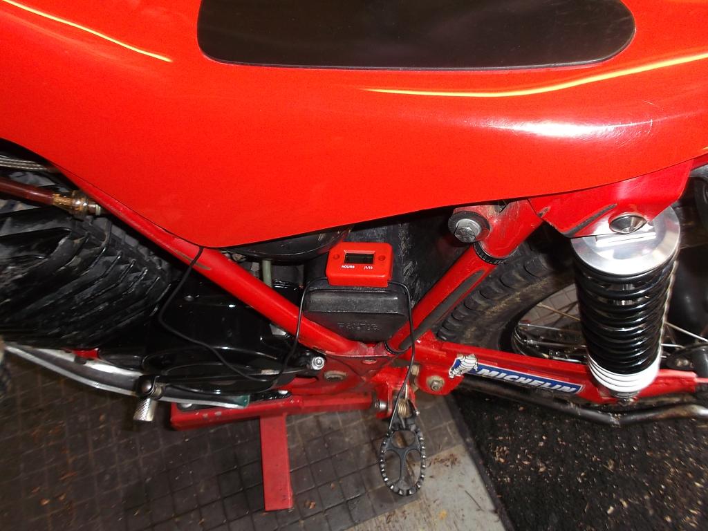

Well I got a couple of the 'bay for 6 dollars apiece ...
Hooked up and functioning but not finished mounting yet ...
And the section already had a spot where the long ago broken wire out of the OE. hour meter/ clock resided , although if and when my custom aluminum tank unit ever gets finished , I'll move it ...
And I even found RED ones !!! :)
