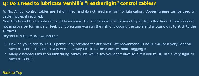

Other lubricant recommendation from Venhill for the cabels then the flush / oiling with WD40 is not provided from Venhill they even warn for using any other oil to cables,
you have to have confused something ...
WP_20150412_12_27_42_Pro__highres%255B1%
This is straight off their website FAQ's
Venhill don't necessarily recommend 'lubing' their cables, but in the real world, after a few years they will need some kind of lube.
