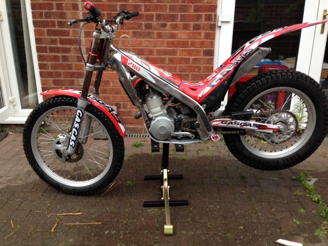

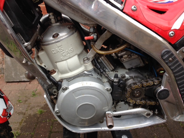

Well I have bitten the bullet and bought it. Here's a couple of pictures. Now I better try and work out how to change the gearbox oil. Lol. Always change fluids on new vehicles I reckon.

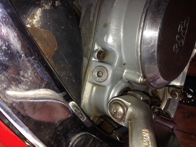

Ok. I shall check tonight and maybe send a photo if i am unclear There is an allen bolt at the top on the right and i think a hex bolt with viewing glass.

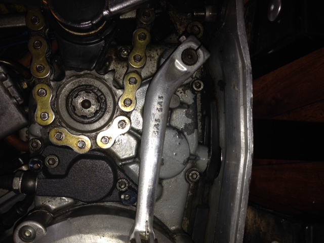

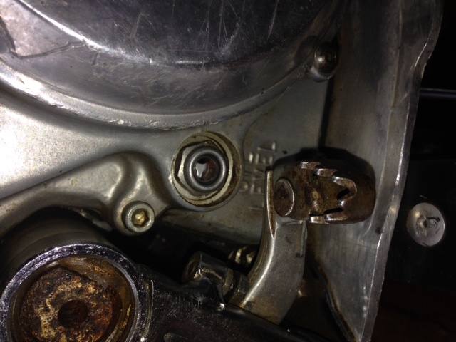

Ok the pictures. The allen bolt  to fill. Is it s view hole below. Drain. Not sure!
I have seen some people say ATF. Are you saying mineral oil ( not synthetic)? A pity I can't find any sort of workshop manual.
See how there is a hole in the bashplate inboard of the gearlever, chances are that is for access to the drain bolt which looks like it would be a grubscrew to keep it flush with the cases
The last picture shows the drain :) From underneath the bashplate.
