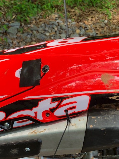

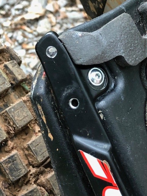

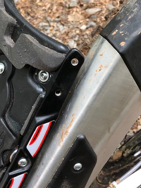

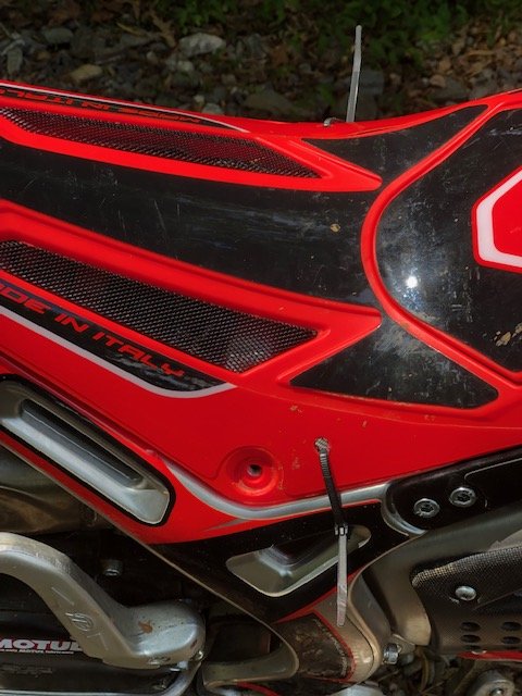

Mucho thanks to everyone who has posted on this topic, in this thread and others.  Since I have a fair amount of experience crashing Shercos, I went the following route.  Pictures speak better than words in this case.
