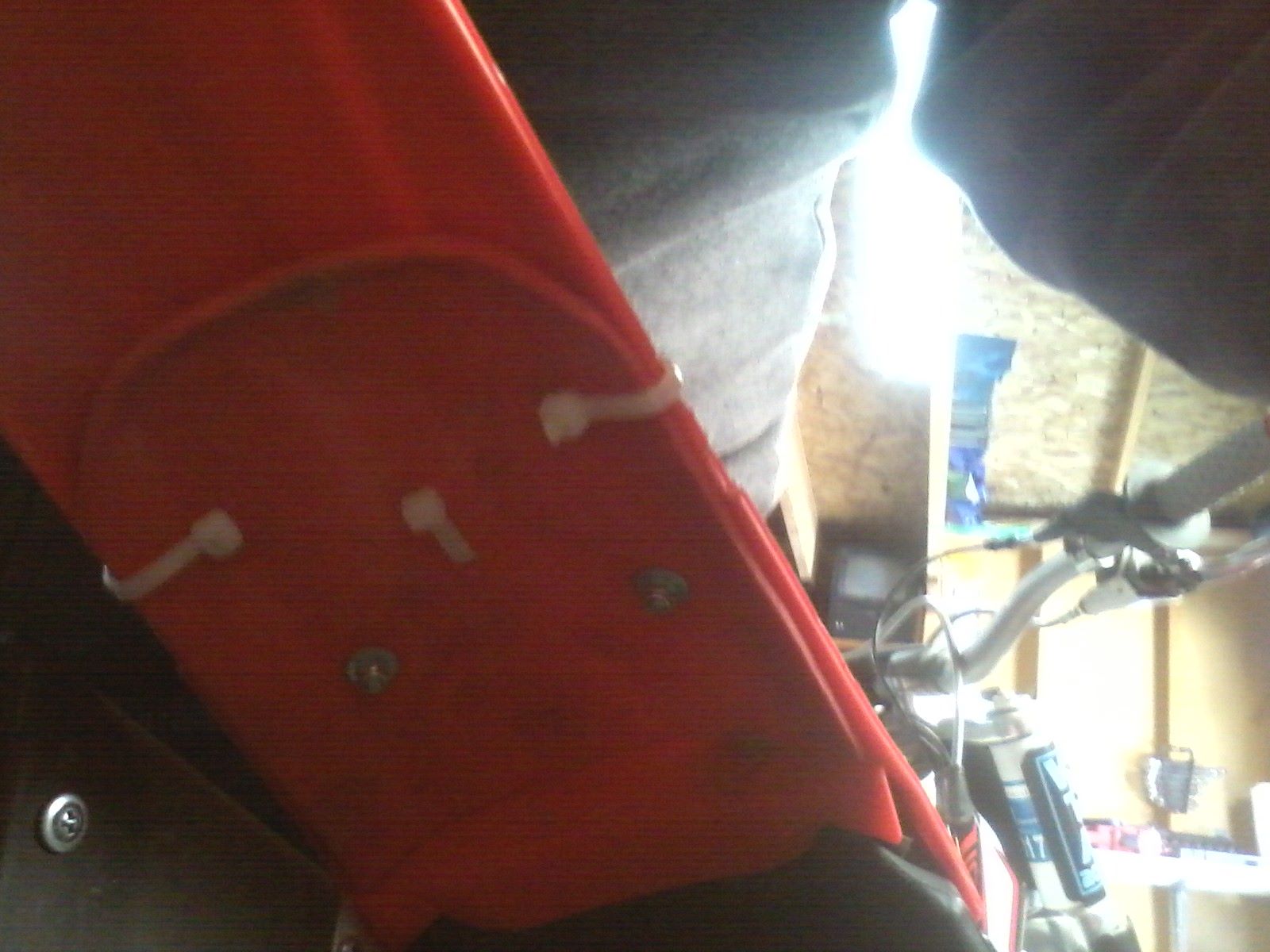

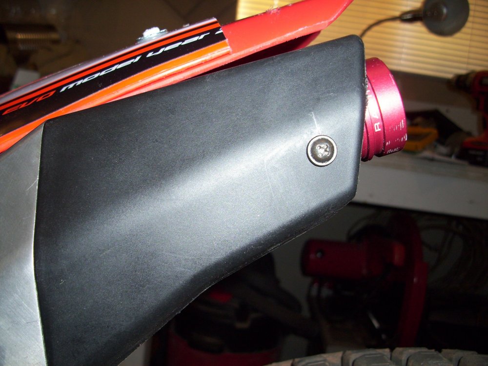

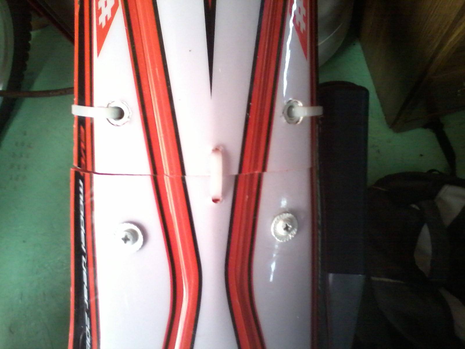

Couldn't figure out how to use zip ties to replace the screws like I had on previous bikes, so trying to be proactive, I bit the bullet and cut the fender so I could remount it with breakable zip ties (and hopefully not break the fender).  I got a rear fender from an 85 CR85 Honda, $19 at RM MC/ATV ($9 on Ebay) to use for a brace. The rear portion of the CR fender is almost a perfect fit for the underside of the Evo fender, it's thick tuff stuff and the color is perfect. So I cut about four inches off the rear of the CR fender, notched it so it would fit up flush against the Evo fender/airbox flange, and put two screws in it through the bike side of the fender and three break point  zip ties through the rear side to hold it on. Sorry, the pics aren't great, but you should get the idea.
