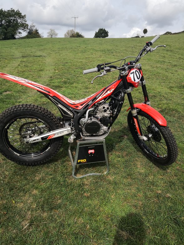

September 17, 20188 yr I just purchased a 2012 beta Evo 300 4t. I have not been riding trials very long and had a jotagas 300 previously. I purchased the beta on its condition and had never ridden a 4t trials bike. Well it was a revelation I did not ride for 2 months or so as had a shoulder injury, but went straight to a trial without ever riding the beta. I was like a kid on Christmas unloading when I got to the trial, signed on then off to the 1st section, i normally ride sportsman and going to go clubman next year, it was a 1 route trial set up fairly easy and the weather had been kind. I had a walk of the 1st section then I was the 1st rider to open the section. Having no idea on gearing I went for 2nd which was a good choice as a climb out of the section let me rev it out a little, the grip level from the 4t seemed amazing and almost endless in the almost perfect conditions, I cleaned the whole of lap 1 of 4 which is better than I normally do, I noticed that my cooling fan hadn't cut in and the 4t was getting very warm so a quick visit to the pits and I bridged the cooling fan so it ran constantly. I also noticed popping on deceleration so think I will give the mixture screw half a turn before next trial. Anyway the rest of the day gave me more and more confidence and I went round clean all 4 laps and that has never happened before!! I really am chuffed with the beta 4t honestly feels like the perfect bike for me in my limited experience! Can't wait for the next trial!! Edited September 17, 20188 yr by bentiggerwyles Spelling

September 22, 20188 yr NIce bike! I also have my beloved '12 Beta 4t. I did a couple of mods to it. braktec master cylinders + monobloc caliper. Finally have a really responsive front brake, brilliant for stoppies and just full control when going downhill. Clutch master improved the clutch feel & response and has lighter pull. For the front suspension, I'm using progressive spring and recently using 7.5wt oil and that changed the response of fork for better. Bigger jumps are much better handled. I've put an Ohlins in the back. Big improvement - traction is really good now and good for bigger jumps, it's nice & smooth. Had a 10t front sprocket, but found that 1st gear is rarely used, and 2nd was v low too. Now i'm using 11t and think it's the better option, but I'm using arrow exhaust so have more punch. Now the 1st is much more usable. And generally rides better - especially after doing jumps, there is not so much engine braking when landing and bike behaves a bit better for me. Gonna keep it for a long time. Nothing has such a grip as me 4t.
