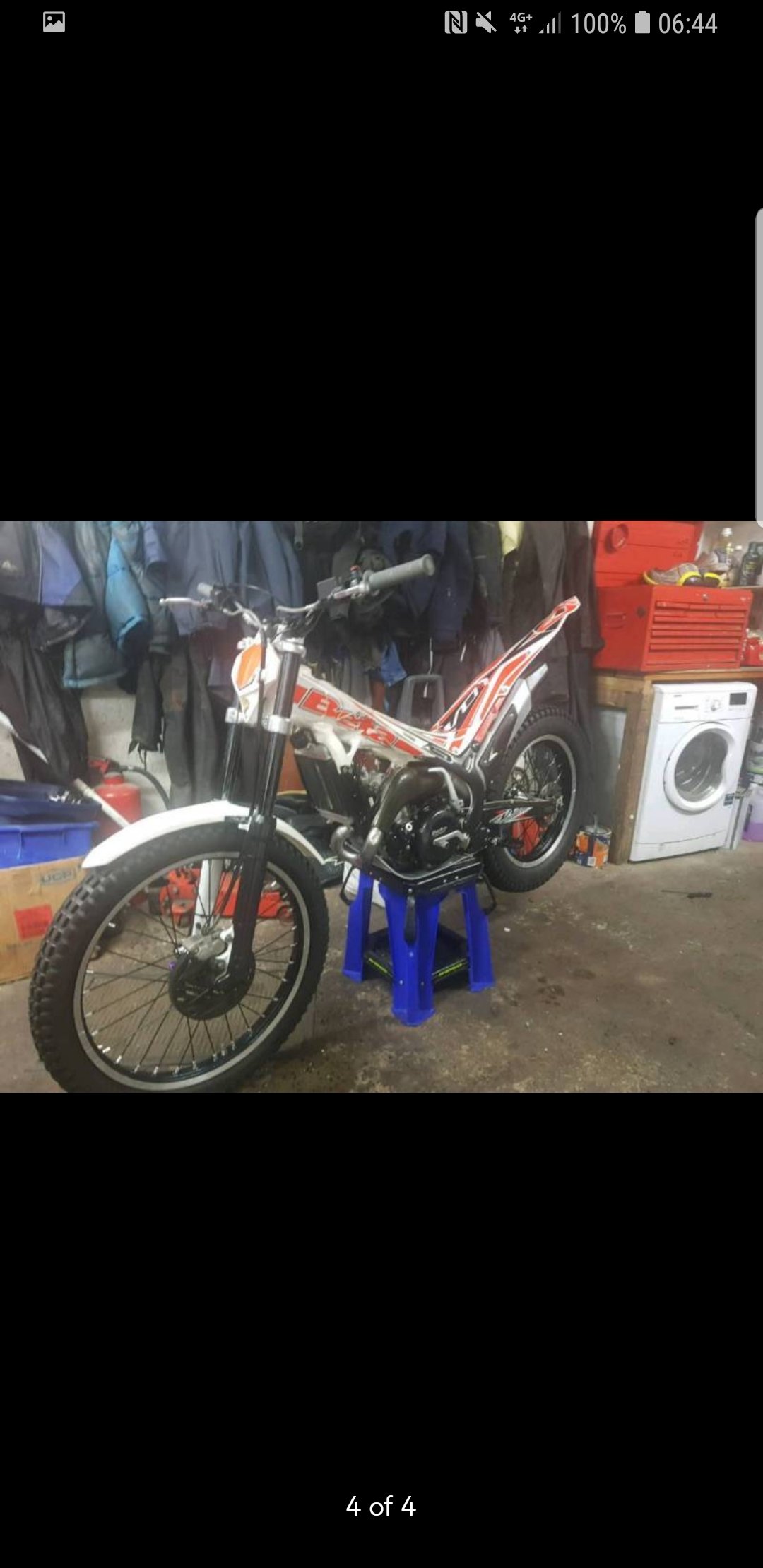

Just bought 2016 beta evo 300 , few questions??
I've just bought a 2016 beta evo 300 , what's the oil fuel mix ratio use guys are using?
And what gear oil would use advise to use?
Is there anything I should check or be aware of for this model also?
Thanks
