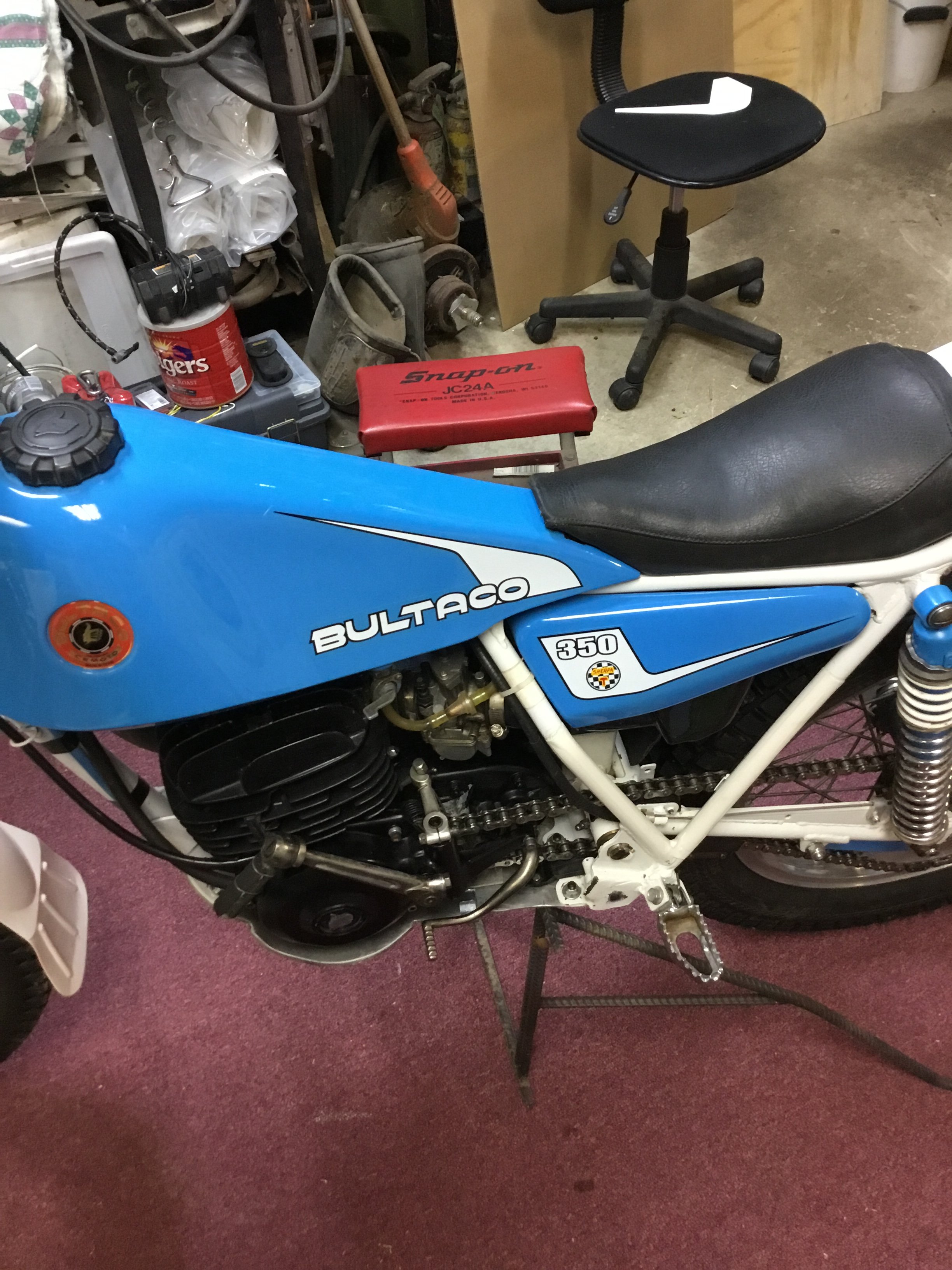

My brother had his 199a tank painted. I warned against spending the money,but you know how little brothers can be. Anyway,that was about three years ago and it,s still holding up no bubbling.The decals were put on this past summer and so far have not lifted or bubbled.The painter used an apoxy primer used for plastic car bumpers and I,m thinking that is why it,s holding up.                                                                                                                                                                                                                                                                                             My 199a was rattle can painted and it and the decals are bubbling pretty bad.They both get drained with the caps left off for a day or so after every ride.

Nice looking Sherpa and I like the Rebar quick lift stand.?
