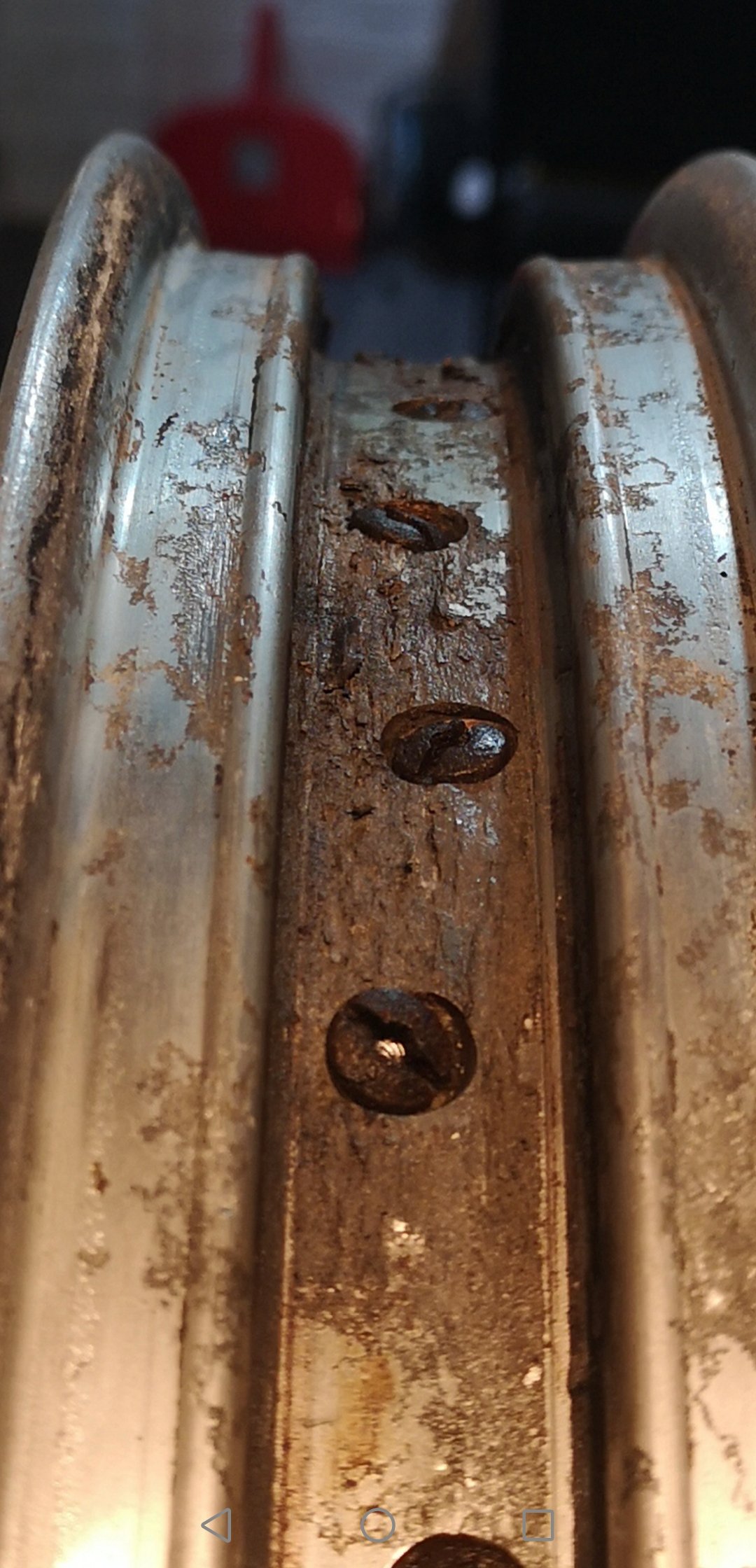

I've cleaned the rim with abrasive brushes and emery cloth but still looks like this:
If that was mine I wouldn't ride it with that rim due to the loss of strength of the metal where the spokes attach.
It's fairly common to have to replace rims on off-road bikes due to internal corrosion

Hi, used to have a txt, and the sealing tape on these rims were always crap. Cheap get around is to seal all round rim with a good silicone sealant, I did this on a txt rim I fitted to a ty175 so I could use the better tyres, putting a tube in stops the tyre being pliable and loses you grip. If you do this leave to dry for a few days before fitting tyre you should be good to go. if you've used a good quality sealant [NOT CAULK] this should last a good while, my ty's 3 years on from rebuild, also the sealant stops the rim corroding anymore, you're rim looks ok for use but if you notice any spokes going slack, inspect rim around spoke and if there's any sign off cracking then replace rim or source s/h wheel.
If you use a silicone sealant be very careful which one you use,  some are very acidic an will rapidly corrode the rim. That's how a previous owner trashed the rim on the txt I had.
If you use a tube without a rim lock it seems to be pot luck if you'll get away with it, some have been OK, but in mine it spun and tore the valve off.
Since you're going to the hassle of replacing the spokes it makes sense to replace the rim. It's hard to tell from the photo if that rim is even safe to use.
If you stick with that rim I'd carefully clean where the sealing tape fits and I'd fit a new tape coated in the type of tyre sealant that you put in to prevent flats like gunk or slime. If it goes flat over a day or two then that's fine, as long as it holds long enough for a trial.
I'm only replacing the spokes I have to, which is probably 8 or 9+? (two broken/missing + loose spokes which are seized and can't be tightened).
If I replace rim + full set of spokes I'm looking at c.£200 on a wreck of a bike.
Regrettably I don't have £200 but even if I did, I wouldn't spend it. This is my first trials bike and I need to see how I get on. If I decide to take things further I'd either sell the bike 'as is' or break it for spares.
I need to be pragmatic and given the overall state of the old girl, she just doesn't warrant the kind of money required to make her competition worthy.

Looking at the rim I would be sceptical the tubeless will seal on the corrosion.  You can save a bit by using duct tape rather than rim tape - you would need the wide 4" tape for fat MTB on a trials rim, or the proper trials tape (£20 - probably will not seal either).
If you are worried about spokes you might just have to bite the bullet and put a rim on, by which time you are at new wheel stage.
