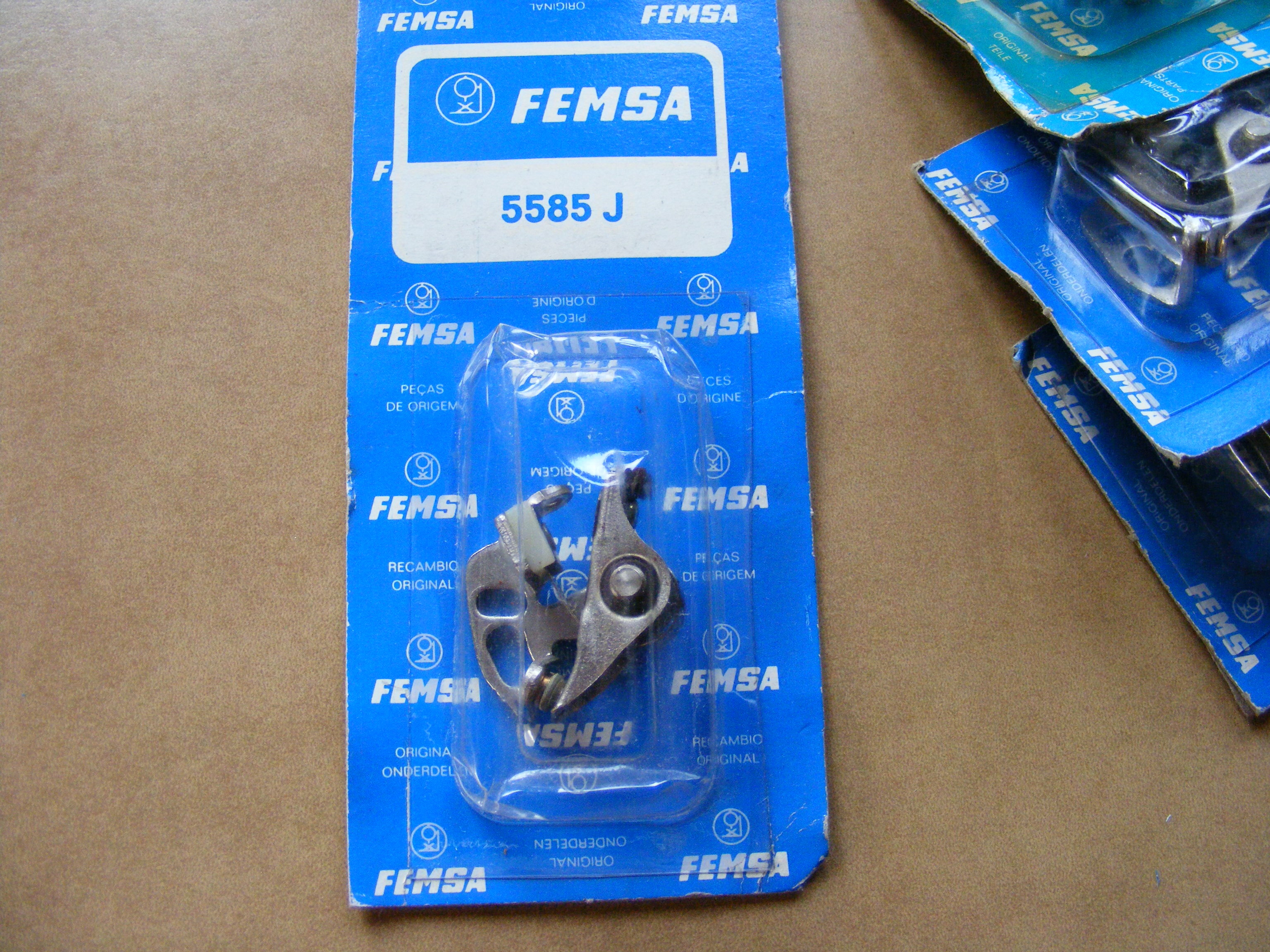

I'm unable to comment on "modern" points, as all I've ever used are these :-
which I believe are o.e.m.
If the contacts you purchased were as bad as you claim, you should return them to the seller for replacement or a refund

My points were obviously a copy and I’ve emailed the supplier today (Feked) Where do you get the Femsa points from? I relocated the new condenser as recommended when I rewired the bike. Multimeter is a good bit of kit, I used to be a proper hands on electronics engineer in my youth before becoming a desk bound email answering ‘engineer’ 😀!
