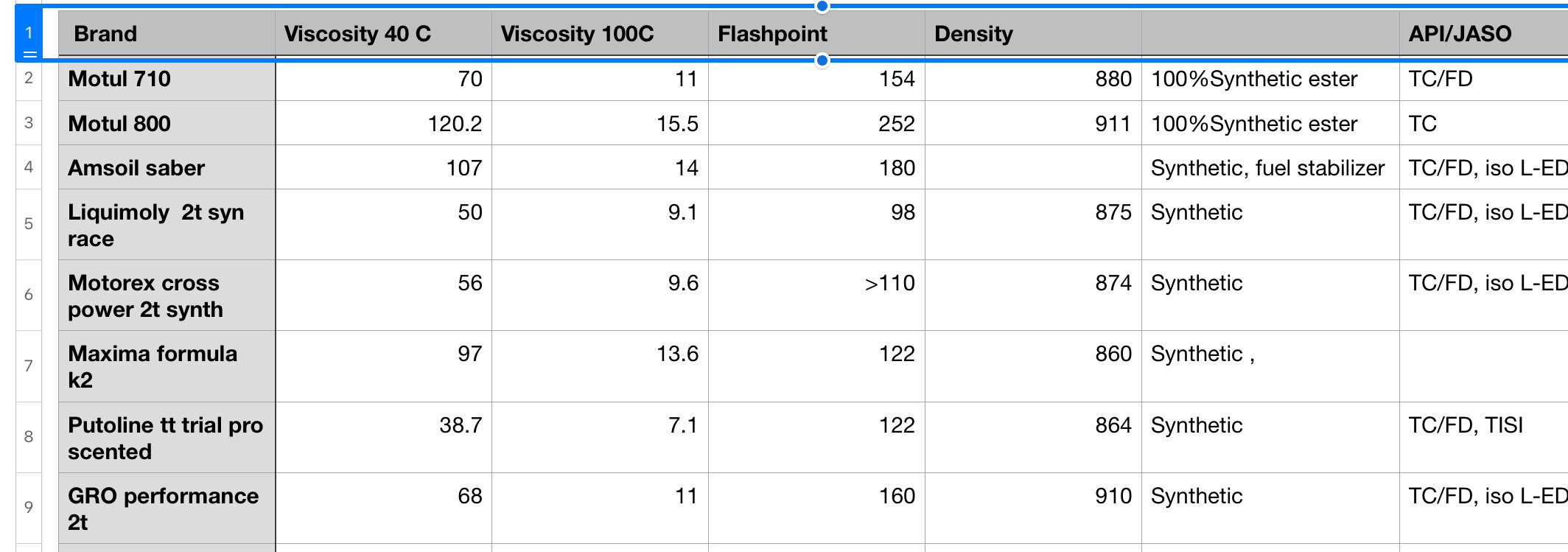

Where do you find the flash point?  Is there a comparison chart somewhere?
Pulled this from various websites.
