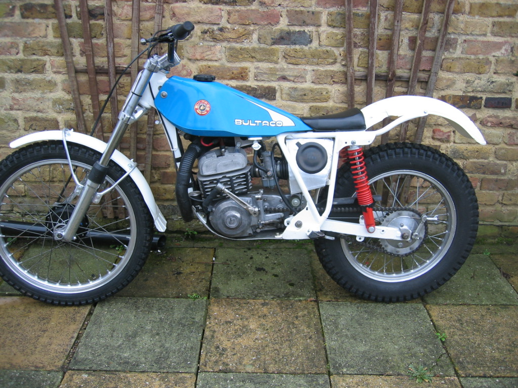

    Dave Renham is the Bultaco expert and he can correct me all he wants, here goes with what I think is the case. Reg May (RIP) converted the 340's as pretty much Vesty replicas, and for about

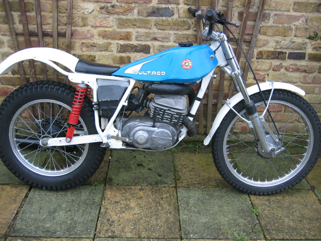

Above shows Vestys bike as owned by a pal of mine 83 I think. Front wheel was swapped for a honda one to get better braking I think rest is as vesty /reg modded it. I think Dave Renham has this bike currently on loan.

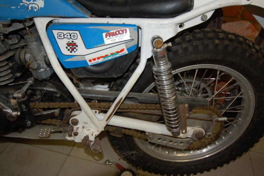

Nice bike, is that what a Comerfords 340 looks like at the back or is that a one off for Vesterinen?.
One of vestys which was the late conversion they did John Reynolds had one like this.Vesty didn't win anything special on this bike which is why my pal got it I think.

That picture looks very similar to a bike owned by a friend of mine in the Sheffield area about 9 years ago except his was a 360 version - used a pursang piston as i remember - it was a six speed with a box section swinging arm and the airbox was as shown above, from what i remember of riding it, it gripped far better than a standard bike and the power delivery was very very soft.

Now I see how they moved the s/arm pivot forward. They took a chunk out of the cases.
Moving the s/a pivot forward must have widened the bike quite a bit ?
That exhaust is not a thing of beauty !
Cases aren't modified, the swingarm pivot is just moved up right behind them
I yield. It's a thought though. Machine a slot in the cases and move the s/arm pivot even futher forward (hopes Big John will bite..)
There was a later bike done for John Reynolds which had the pivot moved even further up. On this bike it looked as though the pivot went through the rear of the cases but the swingarm was actually bolted to the side plates either side so there was no spindle. Don't think there is any room in the cases to allow a pivot to pass through, without reworking the internals that is.
The cases are hollowed away where the swinging armcentre bracet is shortened. It takes a bit of the web but doesn't touch the gearbox internally.
