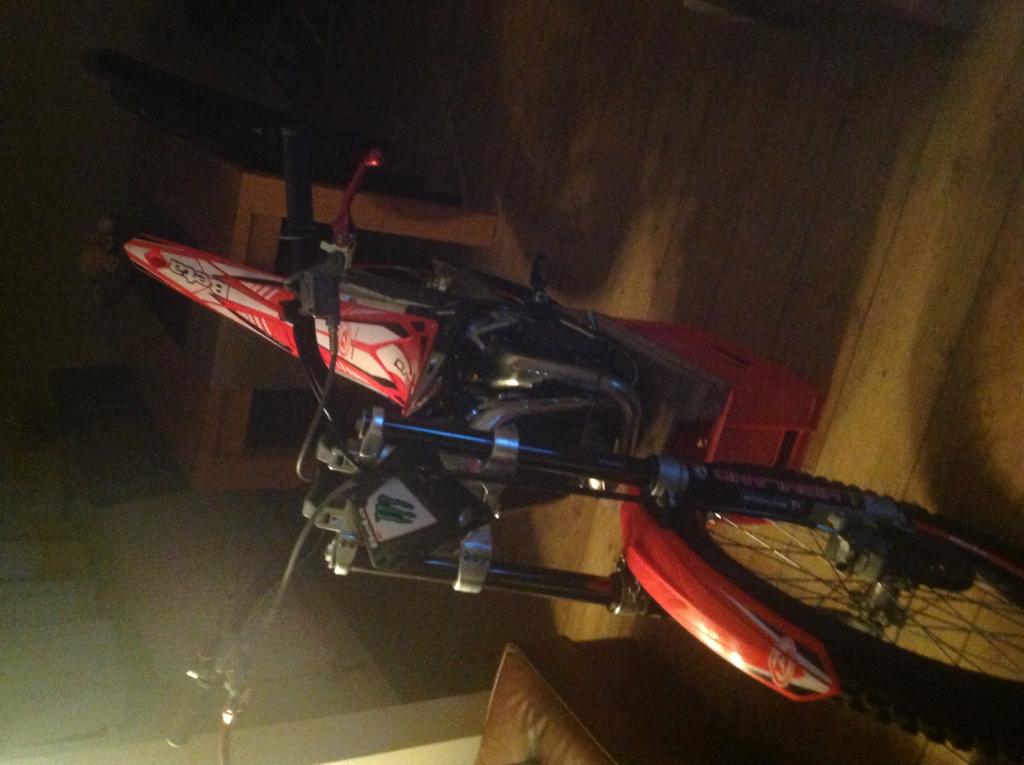

January 31, 201313 yr Author DONE IT !!!!!!!!! did first on dry.........no no no no no no. Don't do that. Listen to the wise tc folk. Ripped old stickers off, easy. Removed glue with solvent spray and white spirit. Removed white spirit residue by giving the plastics a double good fairy liquid sesh in the bath! (She doesn't know;) ) Dried off by radiator. Sprayed mild soapy water on plastic and sticker back, lined up squeezed out water with credit card.... Then applied heat with hair drier and rubbed outwards with thumbs. Took a while but looks great. I wil TRY to get a picture up..... Don't hold your breath tho! Thumbs are killin now....hahaha Thanks for the advice guys....
