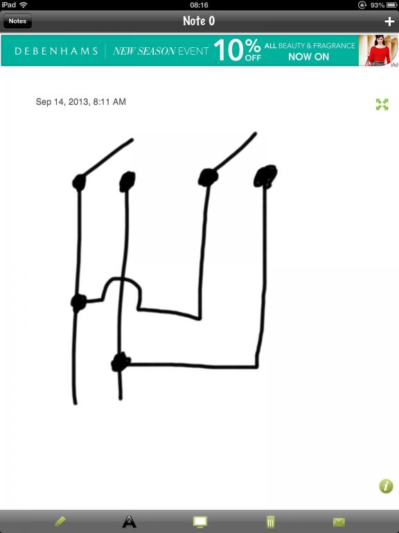

Out of interest how would I go about wiring a lanyard switch up so as to keep my original kill switch too?

I wasn't thinking of 3, was just curious how to wire both a mag lanyard switch and a normal switch at the same time. As I figure It you just wire them both up as normal the circuit would always be complete by one of the devices?

Sawtooth,
I got the same switch as your photo - I took the round ends of the connectors so just had the bare wire, then attached it next to the existing button kill switch, ran the new wires next to the button switch ones and underneath the tank took off a bit of the insulation on those and taped the two together so sort of running in parallel. Tested them both before i put everything back and its been fine - I can use either.... just needed lots of insulation tape and cable ties.

Sawtooth,
Still not quite sure I get it, am a great mechanical engineer, but when it comes to wiring I'm not so good. Any chance you could draw a diagram?

Excuse the the quick sketch but as you can see if either switch is made this will kill the bike!
Thats perfect thanks, I was thinking under the assumption that the circuit was broken when a switch was pressed so yeah that makes sense now. Thanks very much!
