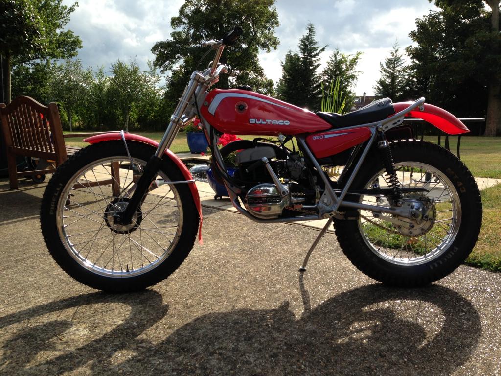

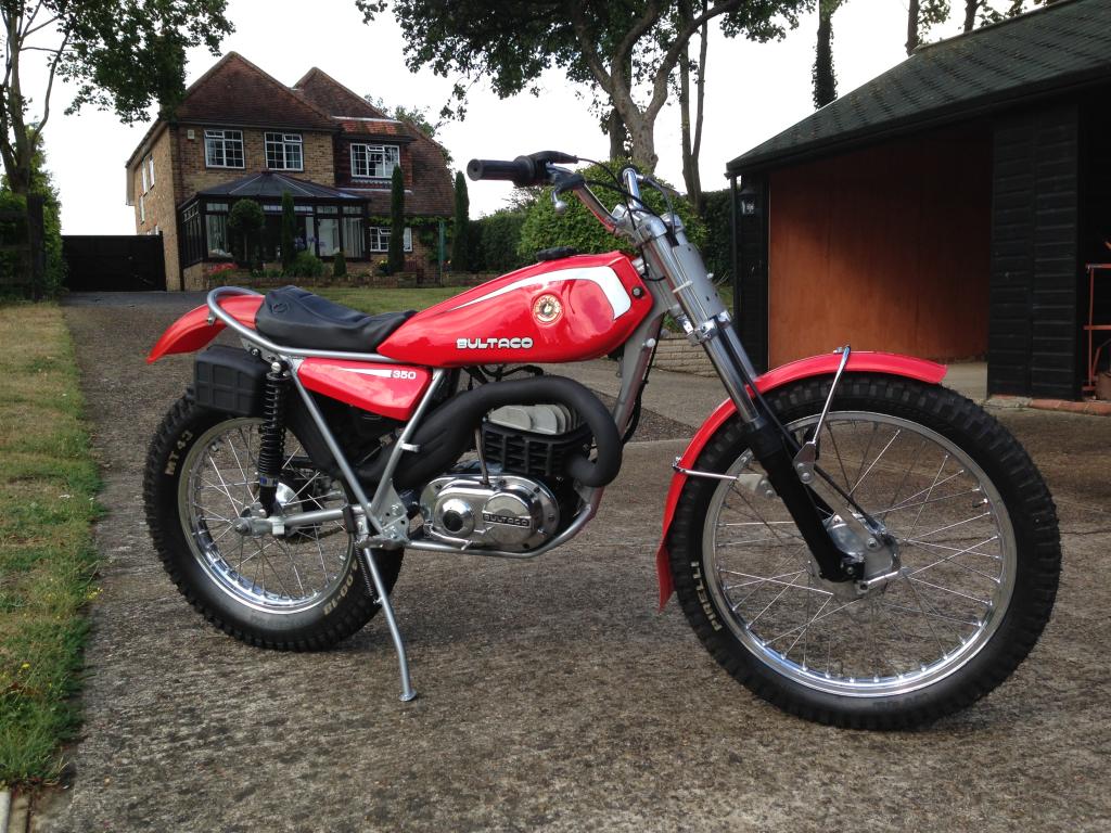

Finally finished the re-build, engine runs really smoothly and now sounds like a Bultaco - vast improvement.
Tank is ali and holding petrol, helicoil seems to have doen the trick.
Anyone spot the obvious mistake?
Thanks for your help and advice.
Besides the fact that it looks too damn good to make it dirty?
The seat maybe?(Doesn't seem to fit the tank properly) Or is the tank from a previous type?
Or the black forks?

When I recovered the seat it fitted perfectly, however the tank causes the front of the seat to 'buckle up' hence the slight distortion!!
Forks and tank are fine.

The shocks are not the same way up! Still looks good though. Well done.
Looks absolutely fantastic. Bet you can't wait for the first muddy section!
Is the alloy tank original, or is the seat? When I restored mine I was told that there are seats for plastic tanks and seats for alloy tanks. It may be that you have the wrong combination.

I think the seat you have is for the later blue plastic tank models, one shock wrong way up and are those front mudguard stays original?
Twistgrip is not original type. Can't see speedometer or its drive

the motor covers have been polished instead of the original black paint finish?
using Pirelli tyres?
AMAL carby (not Bing)?

You are all correct with observations.
Rear shock was assembled upside down, which was the principle question!!
I've not re-built it as 'original' - just to make it clean, ride able (important), and not too leave somewhere looking pretty but gathering dust.
Yes tank is Ali so thanks for the tip re different seat covers. No speedo, maybe at some time in the future, no need for one at the moment.
