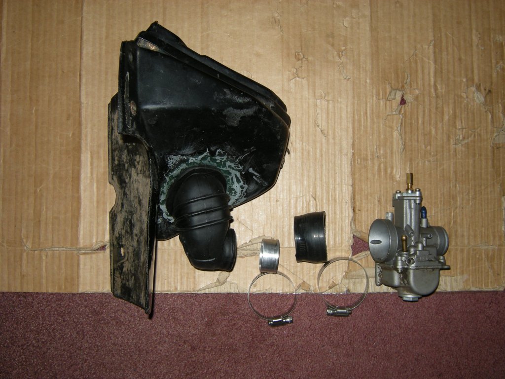

FreeWheel Posted January 16, 2020 Report Share Posted January 16, 2020 I have used one on my Moto Gori tl320. It made the bike sharper of the bottom and seemed to give cleaner running this was purchased from Mid Atlantic Trials and was 28mm. Since then I have tried a 26mm with the same jetting and found this the be more to my taste did not need the extra top end and sharpness from the 28mm since the stock carb is a 26mm. I have made a aluminum insert piece and used a car hose to couple the airbox to the carb as the rubber will not stretch over the carb inlet. This method stops water from getting in. Here is what I did. The OKO Carburettor has an air intake of 49 which means that the standard air boot will not stretch to fit over it. The method used was to use an over sleeve boot which is 50mm to 45mm the initial length of the boot was 75mm which needs to be cut down on both sides this should be done whilst fitting it to the bike. The boot ends up about 35mm in length. The aluminium sleeve has an id of 35mm and two od's 39mm and 40mm. The 39mm has a length of 16mm and the 40mm a length of 3mm so giving an overall diameter of 19mm looks like a top hat spacer adjust this to suit your airbox and carb distance same with the length of the airbox rubber over sleeve. The throttle cable outer is 1105mm and the inner to the cable nipple ends is 1205mm again adjust to your bike this is using a domino slow action throttle and 6 inch rise rental bars. 2 1 Link to comment Share on other sites More sharing options...
