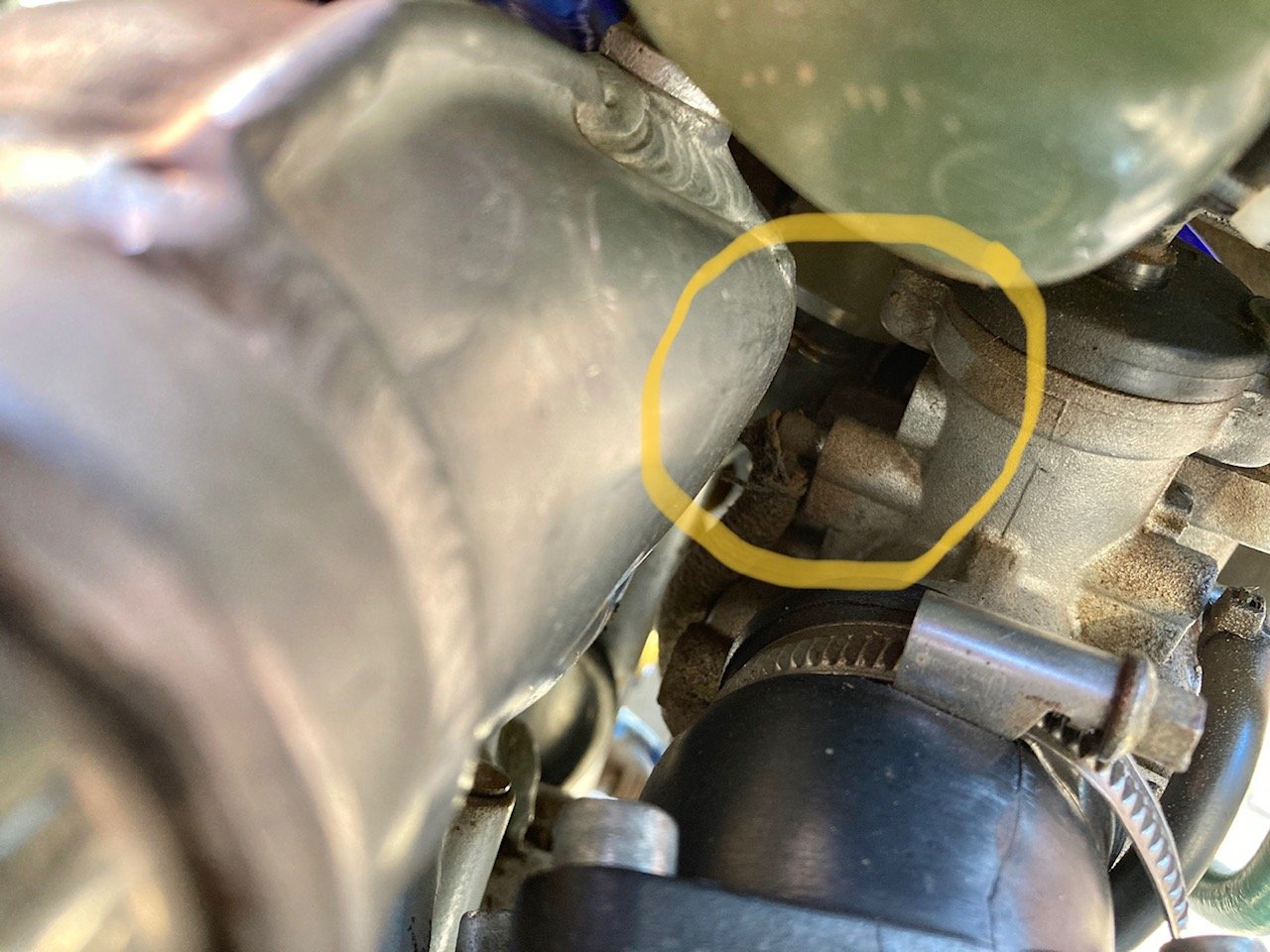

anybody had this problem? my Sherco 2.9 is constantly clogging spark plugs. I believe fuel/air mixture is ok. however it  smokes like we are putting double the 2T oil in fuel.  it takes 1-2hrs and the spark plug goes all black and fails to work. bike doesn`t really have sharp response. i was planning to check the left side crankshaft seal, until i found that from one of the hoses of the carburetor (top one) leaks pure oil. I am really wondering how this is happening. it creates like 20-30ml of oil on the ground for 48 hrs. is there any chance that oil in the transmission enters the carburetor?

 The only way it could enter the carb is if the engine vent was connected to it. Take more pictures.
My guess would be a carb float issue as that looks to be an overflow. All it could leak is fuel, but when it evaporates it will leave oil behind so it could be mistaken for an oil leak.
This would also cause over fueling which would cause smoke and foul the plug.
As far as I know gearbox oil has a significant smell when burned and should easily be detected. Totty79 seems to have a good theory.
That is a vent for the float bowl not a overflow. If that hose is run low on the bike it will actually suck water up the tube if you ride in water. That hose should be routed high on bike.Over flows come out below ventura so if the float needle fails the fuel does not flood into carb.Also check your reed valves as if they are worn and not closing all the way you may be getting blow back into carb.Ussaully when reeds are bad bikes are hard to start and acts like it is flooding out.

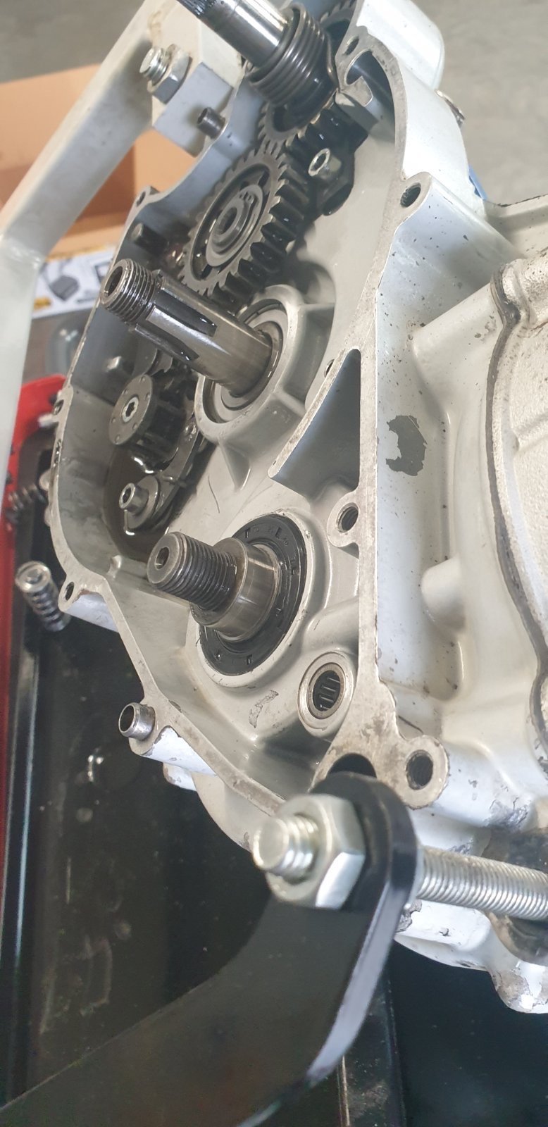

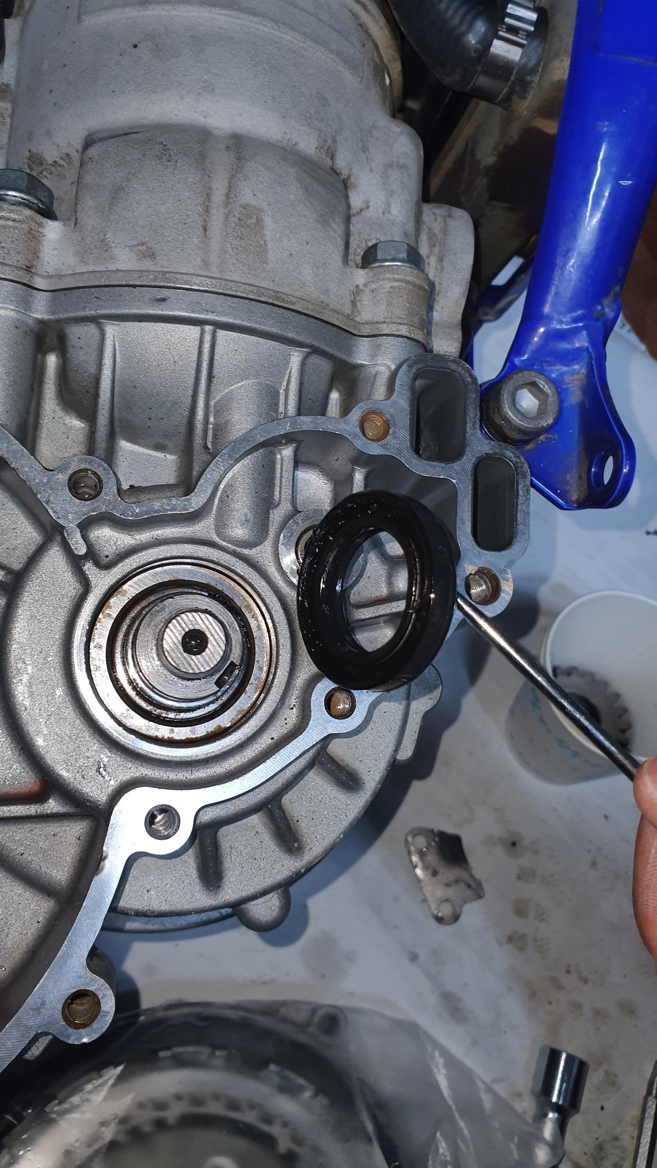

my main concern is the crankcase seal. what i did is that i disassembled the clutch and found out the crankcase seal was a bit sideways, very loose and also i believe it was installed the opposite wrong way. could anybody confirm how it should be. and in case someone can send me a service manual would be great! :)

I just got back from jet skiing for a week. Nobody has a reply? The early SHercos would spin the mains in the case. I would do a complete tear down.
 The fix is ti peen the bearing location on the cases to get it to hold.
