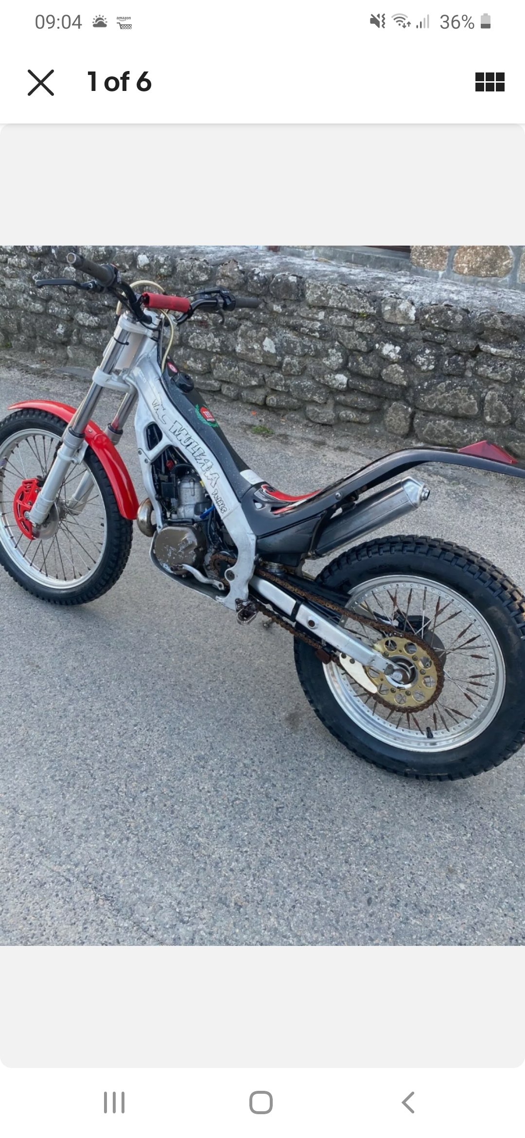

Apologies I'm only just now responding but yesterday turned into a very busy one quite rapidly. The reason for this was that I was doing my normal e-bay breakfast bike ogle, when a 2001 Montesa Cota 315r came up for sale within budget, only 40 miles from home.
Happy to announce that after long and protracted labours yesterday, I followed Jonboy883's advice and I'm now a proud Dad again. Little Monty is currently nestled in cosy and warm in his new home, amongst his siblings both older and younger, out in the shed. Over the moon I am ?
The bike starts 2nd kick, is a runner and rides ok on old boots, but shows signs of quite a bit of use. I suspect the correct maintenance schedule hasn't always been so strictly adhered to, so I'm confident there will be a bit of spanner work to do down the line, to get it back purring sweetly again, but that's all part of the fun for me. Quite looking forward to getting the tools out and seeing what's what. Seller supplied a few small parts with the bike, but no doubt there will be some more winging their cardboard covered way in the this direction soon.
I'll obviously be milking the forum here dry for as much info as possible, but could someone please spare me five mins to list/share a link to, any common issues and things to look out for/give special attention to with these bikes?
Thanks again one and all. Great forum! Looking forward to being an active member here, almost as much as getting out on my new old Montesa Cota 315r ??
Not a 315 expert, but without knowing how well maintained it is from the previous owner, Id say just start with the general cheap things and hope you don't run across something major. Gearbox oil, wheel bearings, grease headstock bearings and regrease possibly replace rear suspension bearings if theres a lot of slop, repack silencer. \

I had a couple of 315 Montesa’s from new back in the day. Bomb-proof and terrific build quality. Faussy’s said it all above. Also worth checking all the other fluid levels (rad/brakes/clutch) and (rather obviously) cleaning air filter.
I honestly can’t recall having any issues or niggles whatsoever. And it will likely go up in value!

From the photo it looks like a pretty clean example.
In regards maintainence, do the basic stuff well, abit like your riding, and the rest will just follow on and should be fine provided it you keep on top of the small stuff.
