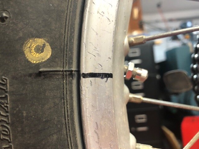

I'm running a Dunlop tubeless tire with tube on a TL250.  It has new rim locks tightened as tight as possible.  Looking at the valve stem, the rear tube is rotating on the rim.  I assumed this must be the tire rotating but I marked the tire/ rim before last ride and it is not.  The valve stem is noticeably angled with only one very mild ride.  See pic with line and stem from one ride.  The line is from black marker to black marker and not related to raised line on tire.  This is strange.  Is there a fix?  To recenter valve stem, I have been doing a number of deflation and inflation cycles with a tightened valve stem nut and it does straighten out.

Have you tried popping the tyre off the bead and rotating the rim around within the tyre to rectify the valve angle, then reinflate and bead the tyre and see what happens.
Yes it's a normal thing to have the tube creep inside the tyre. It can be quite persistent. If you can get the tube to adhere to the inside of the tyre it won't creep but that can be difficult to achieve. I've found it is less likely to creep if I use a 4.00-4.50 tube rather than a 3.50-4.00 tube. I have also found it happens less with Michelin X11 rears than with IRC rears.
If you leave plenty of room in the rim hole for the valve stem to lean over I've found that the tube will only creep so far and the tube stem stops it creeping further (I found this because I got sick and tired of moving the tube stem back straight when it leaned over due to tube creep.)
Yes, tubes are wandering inside the tyre. Tightening the rim locks doesn´t help
This is a trick I learnt from a Speedway guy. Empty the tube. Push the bike backwards until valve position is correct. Fill the tube with air. This has to be repeated every 2nd occasion or so.

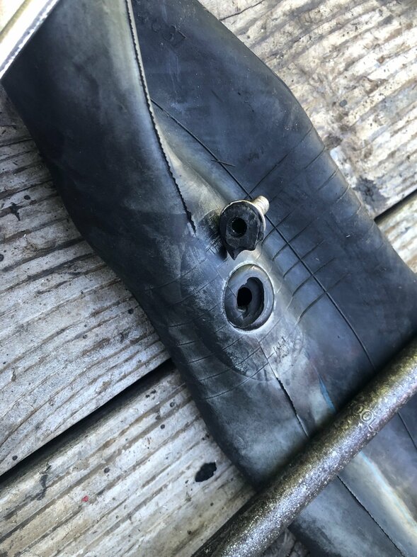

This issue continues.  I was deflating and reinflating tube to get it centered every couple of rides.  I also increased pressure to 5 psi.  In other bikes I use 4 psi.  I stopped the deflation/ inflation step and developed a leak at the valve stem in a maybe 5 short rides.  I installed a 4:25/ 4:50 tube and ripped the stem off in only a few miles of dirt with no rocks.  There was no impact.  I just came around a turn on a flat road, gave it a good bit of throttle and could feel it go flat all at once.  The tire remained seated on the rim.  I rode the bike about 1/4 mile with the flat and the tire was still firmly seated on the rim.  The bike has a DID 2.15 x 18 rim.  This is really odd.  I'm not sure if I should try an IRC tire or maybe the tubliss system.  Does anyone run Tubliss on a trials bike?

Seems that there is sufficient radial movement in your low pressure radial tire to rip the valve stem out of your bias tire inner tubes without the tire bead sliding on the rim.  When they run a mousse in an enduro bike tire they lubricate the mousse so it slides inside the tire without damage, maybe you can similarly lubricate your inner tube so it isn't damaged by the tire movement in the radial direction.

1 of our local twinshock guys runs the Tubliss system & hasn't had any problems with it

I ended up going to the Tubliss system and the issue appears to be gone.  I expected mounting to be quite difficult but it was not bad.  I see their claim about it being lighter.  I did not weigh anything but I would say... maybe and it probably depends on the thickness of the 4:00 x 18 tube you are running.  The 18" tube and two rim locks go away.  You add a skinny bicycle type tube, plastic cover and  lightweight rim lock/ pressure valve.  Provided plastic tape replaces the rim band.
