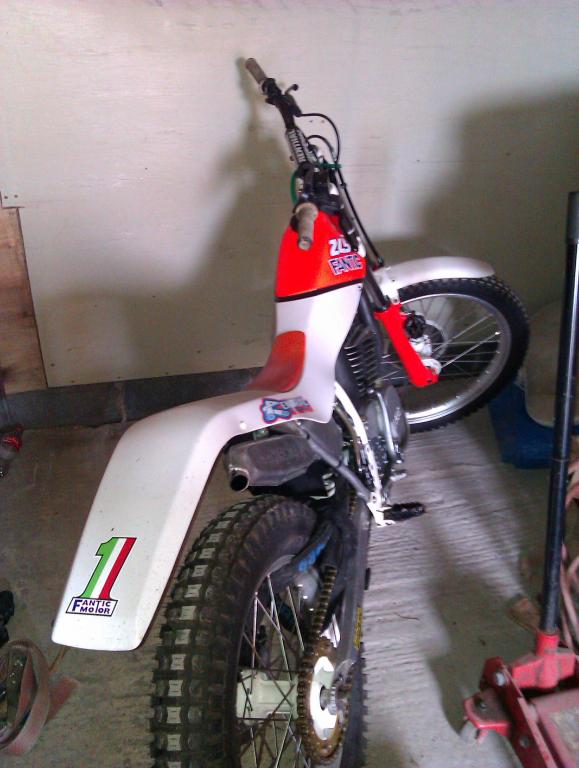

you know when you have something to sort out that you ve been putting off.. well today i grabbed the 200 by the forks and sorted it.. BOOM.
the 200 forks have wept for a while but not from the seals, right down at the bottom where the screw goes into the damper rod. on advice i stripped em right down again and cleand up the surface, howeverassembling the real issue became obvious.. althouigh apperaing nice and sugly tightened up ther was just a smidgen of up and down movement so i whipped it ot added another washer and BINGO. the fork now holds oil so i reassembled with a new spring from inmotion ( site sponsers..) and a correct length spacer and 150ml of 5wt oil and 3 hours later its still oil tight.
whilst about it and inspired by vestys weight reduction i reached for the chop saw and had the lock off the headstock ( 153g as you ask) .
at some point the brake cable stay had become 'lost' so the brakes needed fettling once a replcement was sourced form a well known tinternet auction site beginning in e and ending in bay
i added a new cable and shoes from a site who is not site sponser but offers next day service and cheap prices..
the shoes/ drum interface was a bit 'baggy' 'slack' the root cause been the drum would benifit from a skim but needs must so i packed the trailing shoe a littel and the front stopper stops, not as good as a disc but it stops..
fuelled it up two kicks and bingo riding leak free, the only downside the other leg will need its spring and oil changing before we move on to tuning the things.. as they can work well these mazzochis.. and how do we know ahh confesion.. a new italian mistress..
