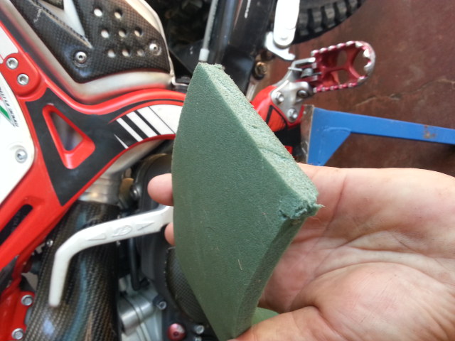

So my plan is to try jam a pool noodle in the front tire. Either just a noodle and no tube or split the noodle and use it between tube and tire, like a thick liner.

Im actually thinking of using a closed cell foam camping mattress and cutting a strip to line the tire then still using the tube. A camp mattress is denser than a noodle.

I have some material that rubber ducks/dinghy s are made from, wonder how thorn risistant it is. Ill try poke a thorn through some tomorrow. Im liking the camp mattress liner idea sofar just depends how much 6psi will compress it. No point if the tube squashes the foam flat against the tire.

Well I managed to get 2 layers of 10mm mattress foam in the tire with the tube. Just put 6 psi in and praying I havent pinched it. So far its looking good and it "feels" right when you give it a squeeze. The foam is VERY lite and I cant even feel a difference in weight. A thorn now needs to get through the tire and 20mm of foam (10mm im guessing with preasure in the tube) to get to the tube.
Will keep you updated.

Its dropped by 1 psi but I think thats the foam settling in. Im expecting it to drop a touch more then stabilise.
