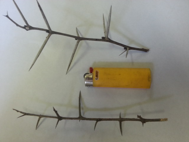

Spelling isnt my strong point :). I get paid to find animals :D
Nope Zippy, havent seen those before.
Just so you can see what im up against. I had to reach out and grab a branch, thats how common they are. Its the bigger Bic.

Ignore the groove at the bottom of the lighter, I dont open that many beers :D

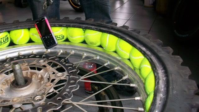

I know alot of enduro riders that swear by tire balls , they say that there a pain to install the first time , but once you get the hang of it , there not bad to do . And no lost minutes due to flat repair on the trail ...
Glenn
Im keen to try the tennis ball trick if my foam doesnt help. Wonder if adding a second bead lock where the valve normay goes would help?
My first post I ment the `tire` from a bicycle. Maybe a road tire. Flexible enough to fit the tube, but give you that layer of protection. The southern part of our state has thorns like that. Every plant and you would even swear the rocks are that way. We get flats, but not as often as you are having.
Just got back from a 2hr ride. My camp foam tire feels great. I checked the preasure now and its at 5psi, so another psi drop. Would like to know how thick the foam is when it settels in but no way to check untill I have to remove the tire. Oh well, no flats yet even though I tried :D
I would think that you'd need some kind of valve (probably a tubeless one) to seat the bead.
The scraping noise of those thorns going up under the mudguard would drive me crazy. :blush:
Taff
Hi Taff
These thorns do get picked up and then broken off by the mud guard leaving the thorn in the tire. Then, as we do, you ride over a rock and with our low preasure, the rock drives the thorn home.
Im my game drive vehicle, I run the tires at 3 bar to help prevent this happening.
Looking at the photos of the thorns & your description of what happens I'm guessing that Michelin x-lites aren't used there
