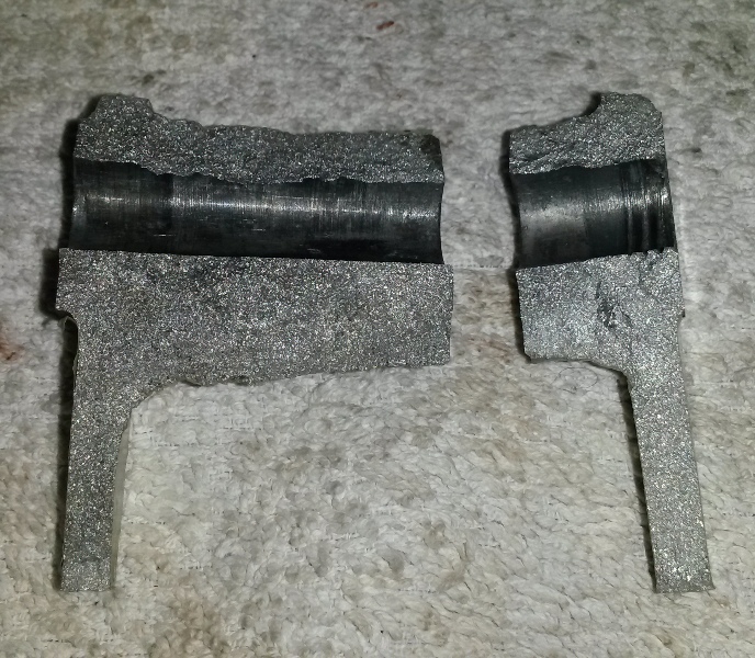

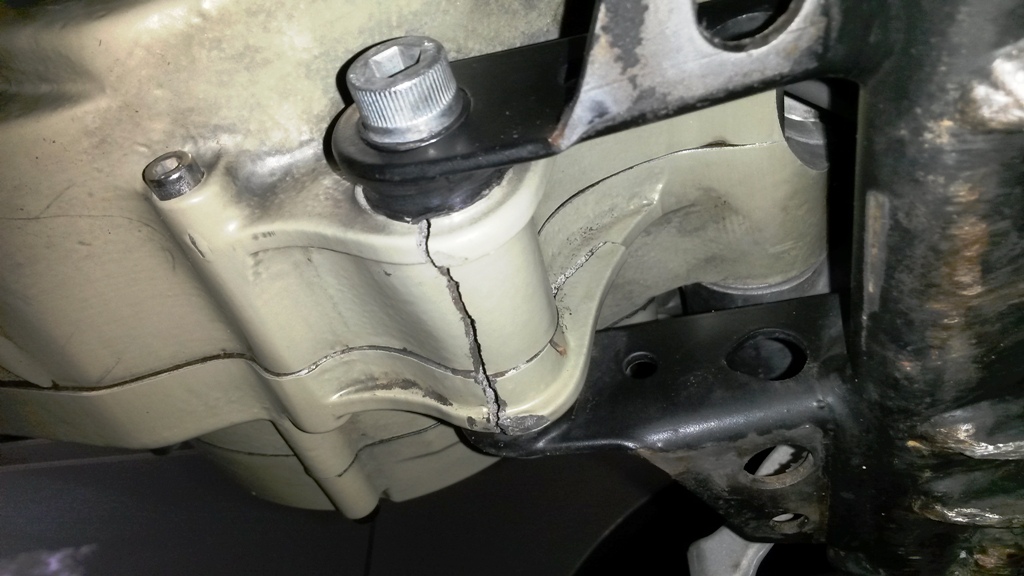

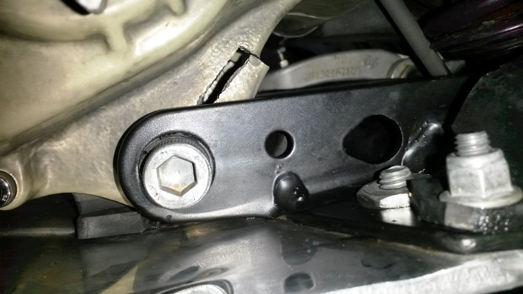

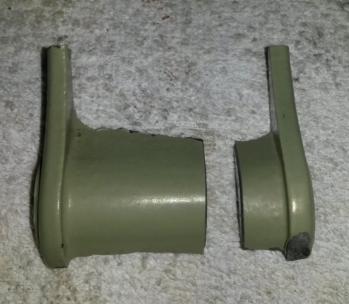

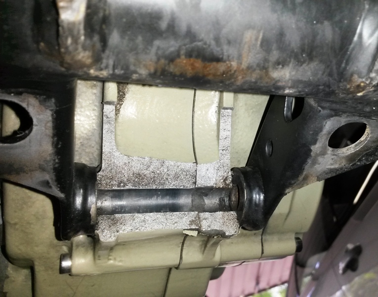

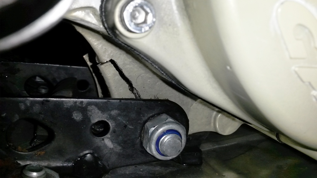

This is my beloved 2011 Raga 300. After the usual weekend practice and a thorough clean, I discovered both crankcase halves have broken around the lower rear engine mount. These are magnesium cases. I know there has been a reported issue of misaligned holes at this mount but I checked it about a year ago and it was perfect (no drilling necessary). Obviously this is what we have to expect to have a lightweight bike.
Anyway, new magnesium cases appear to be unobtainable. I'd be happy to replace them with the standard aluminium ones hoping they might be stronger. The problem is that the local dealer appears to only have one half in stock and I thought they were sold as a matched pair. Looking at the Gas Gas Future thread, I'm guessing the factory won't be shipping any parts soon. So I might be testing my welding skills (I can weld aluminium but never tried magnesium).

Anyone with a pro should compare their skidplate shape with a new one. If it has been flattened you are prone to breaking the case or brackets. Luckily the bracket broke on mine before the cases. I am able to hammer it back to curved with a 16lb sledgehammer and put in some new rubber cushions.

There are 3 problems welding this case. 2 of them specific to magnesium.
1) The casting may be porous and may have absorbed oil which makes a good weld impossible. Warming it with a blow torch and flushing in brake cleaner usually gets rid of sufficient oil.
2) Magnesium shrinks a lot on solidification and a further 1.5% on cooling to room temperature, this causes cracking.
3) Some magnesium alloys are flammable (porsche wheels for example) but bike parts generally are not. Test for this by melting a portion of the broken off piece the pulling the TIG gas shield away sharply.
To repair this I would not try too weld the broken piece back on. I would butter the broken surface with several layers of 4043 using minimum heat input pulse / intermittent technique, Then I would weld heavy aluminium straps across the surface, at 90 degrees to the bolt. The straps would be something like 12 wide by 6 thick flat bar.

Looking at the right hand side of the broken piece, it looks like it may have taken a hit from the bashplate.
Is there a mark on the plate relating to that point?

I think the main problem is that the rear bash plate rubber was worn through and, as Steve suggested, there has been contact between the bash plate and the mounting lug on the case. I need to replace these rubbers maybe every year.
