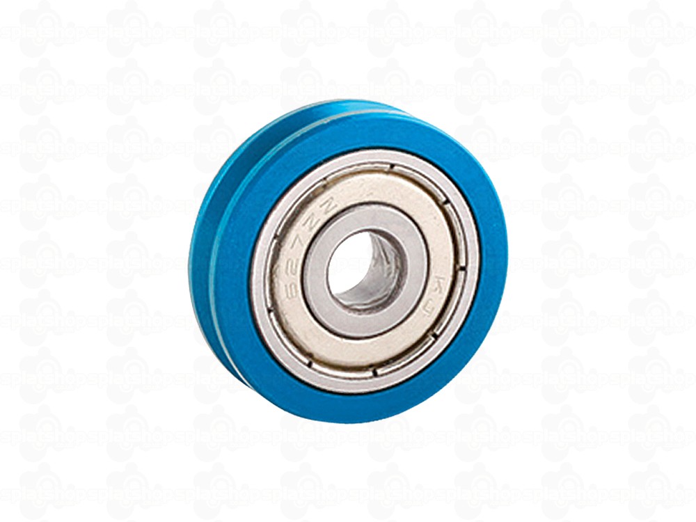

Have seen this Domino throttle wheel on net. Have someone tried one? Any improvement?

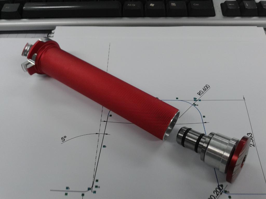

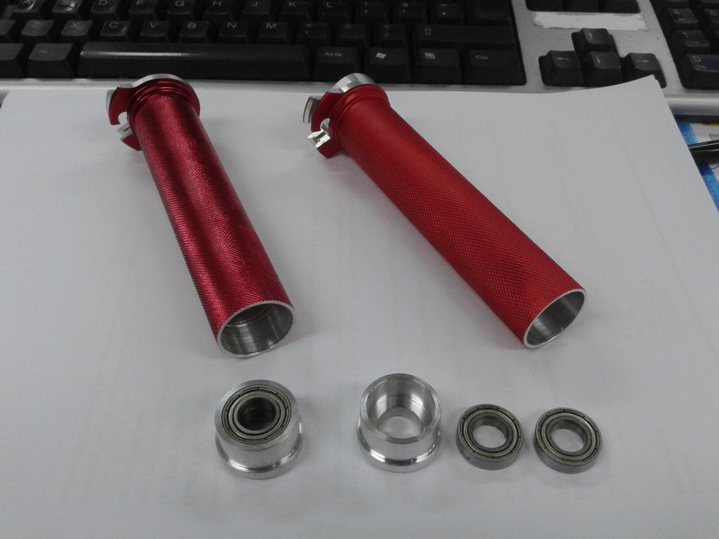

post-20328-0-22024900-1449570384_thumb.jpgpost-20328-0-62661500-1449570407_thumb.jpgMade  quite a few of these for guys locally - good reports back on em , I charged £25.00 if your interested, coupled with a jitsie roller wheel made for a very smooth throttle - unfortunately has not improved my skillz!!
I found the jitsie end roller a bit agricultural....
attachicon.gifmatts 4.jpgattachicon.gifmatts throttles.jpgMade  quite a few of these for guys locally - good reports back on em , I charged £25.00 if your interested, coupled with a jitsie roller wheel made for a very smooth throttle - unfortunately has not improved my skillz!!
Additionally this is a totally enclosed system so ingress of anything wet or abrasive is impossible. ;)
My problem with this end tube bearing is because the system is exposed in case of a fall. And the aluminium throttle tube can bend and stick open.
With a lathe at home, I can give the throttle wheel a try spending almost nothing. If results aren't good due debris on ball bearing, I can try a bronze bushing like my enduro.
I'm using one on my gasser and it feels smoother and more precise. Like it
I've done it this saturday. It improve the throttle a bit. Just a bit
